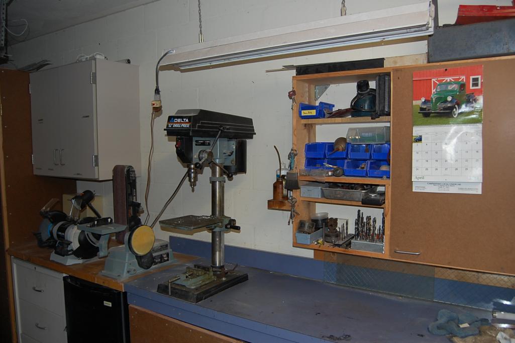

Drill press is on a peice of plastic laminate counter top.....

URY914   Drill press is on a peice of plastic laminate coun...   Dec 20 2012, 07:28 PM
