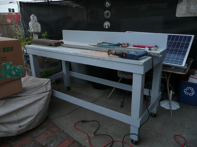

This is a freebie I picked up from one of Joe Sharp's neighbors earlier this year (IMG:style_emoticons/default/smile.gif)
4x4 legs, 1x4 rails and 1" particle board top. I added a shelf on top of the lower rails and wheels to move it about. I may cover the top with a sheet of galvanized steel at some point (IMG:style_emoticons/default/confused24.gif)
This is a second work bench ... my garage is so cluttered, I can't even get to the work bench in there (IMG:style_emoticons/default/dry.gif)
The price was right (IMG:style_emoticons/default/biggrin.gif)
