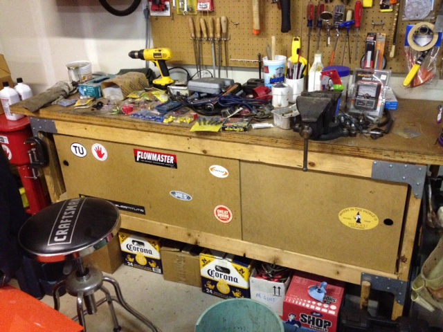

I made my bench 15 years ago. Put a solid core door on top of it. And on top of that I put 1/4" hardboard, with screws here and there, countersunk. Nice and smooth and if it ever gets all stained or shit'd up, I can just replace the hardboard top. Haven't had to do it yet. And this thing is a ROCK!
Sliders on the front. 3/4' MDF on the bottom, peg board sides and back.
