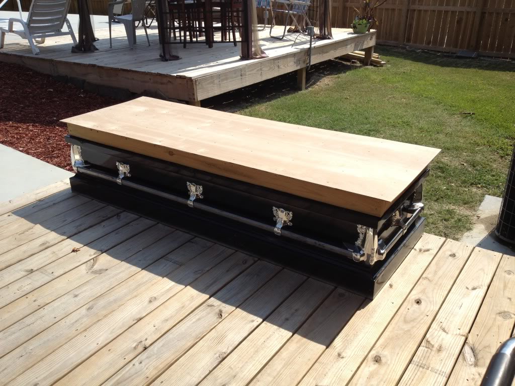

I am with scotty on the freebies. I found some great parts just left behind in an old churchyard. I built a great work bench last summer with it. It's going to be great because you can just flip the top up and store all kinds of stuff in it, once I figure out how to get it unsealed that is. I also need to add a lower frame to bring the height up.
