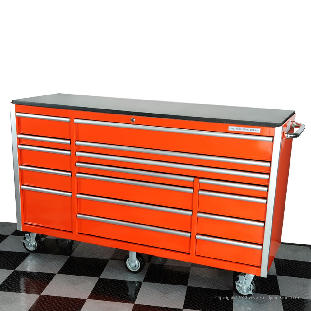

Yeah. Here you go ... roll away and bench in one movable unit (IMG:style_emoticons/default/idea.gif)

euro911   Yeah. Here you go ... roll away and bench in one m...   Dec 23 2012, 01:29 PM
