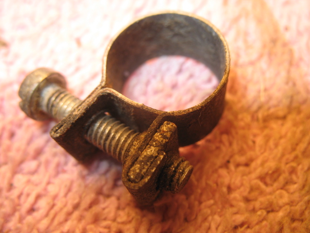

seems to be some lively discussion going on - and no one is using duct tape (IMG:style_emoticons/default/biggrin.gif)
pic of original that came off one of my car's reservior line (IMG:style_emoticons/default/blink.gif)

rfuerst911sc   I believe they are called fuel injection hose clam...   Dec 31 2012, 04:57 AM
Nine_14   I believe they are called fuel injection hose cla...   Dec 31 2012, 06:54 AM
DBCooper   Not to use with FI Uh oh. Are you sure? That...   Dec 31 2012, 09:15 AM
Nine_14   Not to use with FI Uh oh. Are you sure? Tha...   Dec 31 2012, 10:06 AM

Nine_14   what is your source for these? German Market, ...   Dec 31 2012, 10:28 AM
kg6dxn   http://www.ebay.de/itm/Schlauchschelle-Spa...d#ht_...   Dec 31 2012, 10:40 AM
DBCooper   Those clamps, the Napa photo and the German, both ...   Dec 31 2012, 10:44 AM
Nine_14   Those clamps, the Napa photo and the German, both...   Dec 31 2012, 11:02 AM
7TPorsh   $2.99 pack of four http://www.pepboys.com/pr...   Dec 31 2012, 10:45 AM
Nine_14   You've got it Clamps like this are not avaia...   Dec 31 2012, 10:48 AM
r3dplanet   The second photo there shows something more like ...   Dec 31 2012, 11:03 AM
Nine_14   The second photo there shows something more like ...   Dec 31 2012, 11:42 AM
Cap'n Krusty   The "real" FI clamps have rolled edges, ...   Dec 31 2012, 11:44 AM
Nine_14   The "real" FI clamps have rolled edges,...   Dec 31 2012, 11:55 AM
