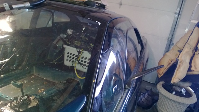

Just a bit more progress to report. Should drop the drive train today or tomorrow. A few pics...

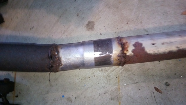

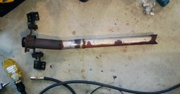

So here's the cause of the "slight" exhaust leak. This is the pipe coming off of the main cat... man that thing was loud... check out those welds!

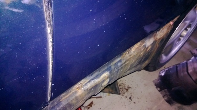

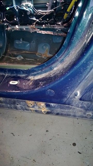

In case you are looking for an SVX to drive (not part out), the areas to check for rust are the doors as well as the whole belt line of the car. Like Honda Civics of that era and others, the SVX has a plastic lower panel. Water can get trapped under the plastic and cause rust. Other than that it seems OK aside from the leaky sunroof issues.
Oh no rust in the long! not really...just surface. (IMG:style_emoticons/default/biggrin.gif)

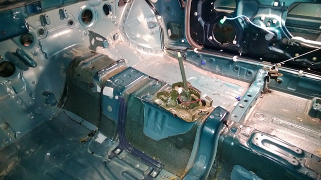

The windows are a PAIN to get out...Step 1 is to undo all of the bolts you can reach with the windows UP. Then roll them down and do the rest. The windows will not come out if they are rolled up. Best to leave the battery hooked up or close by in case you have to roll them up or down again.
Don't wrestle with the shifter from the top. You can take off the trim but it's almost impossible to remove that way due to the position of the cable bolts. Get it from underneath.

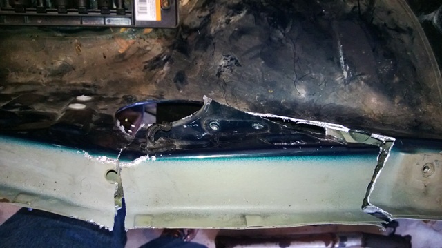

To disconnect the engine fuse box/wiring harness you do not need to cut a section of fender like I did. Just follow the wiring into the cabin and they are connected to the back of the main fuse panel. Pull the engine panel out and connect it RIGHT BACK.

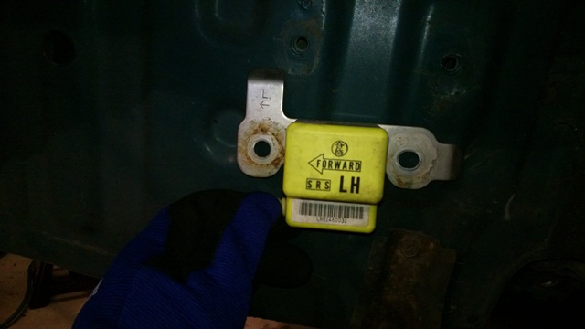

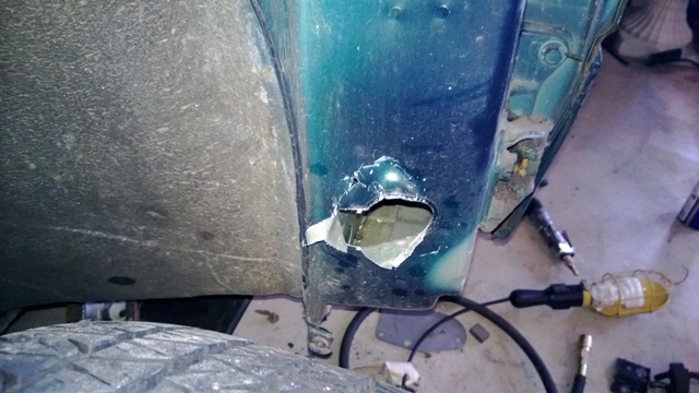

Conversely the best way to remove the SRS sensors from the fenders without cutting the wires is to cut a slightly larger hole and push them through so they end up in the interior of the car. Don't wrestle with trying to remove the wires from the main control module. There is something more to that process that is not worth wasting time figuring out...

Chris H.   Thanks guys. Got the harness out... Empty basket...   Dec 29 2012, 03:34 PM

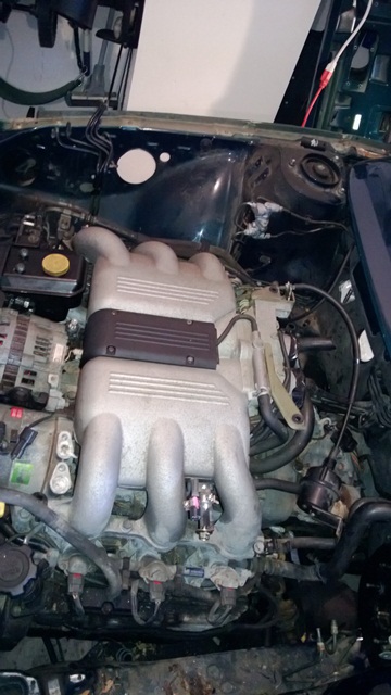

Chris H.   Just some minor updates...the exciting stuff will ...   Jan 23 2013, 06:44 AM
Chris H.   So the angle of the intake has gotten my attention...   Jan 23 2013, 06:44 AM
Chris H.   Here's a better shot of the angle... And t...   Jan 23 2013, 06:54 AM
76-914   Chris, what is the issue with the TB and Alt? I di...   Jan 23 2013, 08:11 AM
Chris H.   Sorry what I was saying is that it appears that I ...   Jan 23 2013, 10:27 AM
scotty b   If you flip it, will you still have enough room to...   Jan 23 2013, 04:51 PM
wingnut86   94' had an EGR valve in the location under the...   Jan 23 2013, 09:12 PM
Chris H.   Sorry guys I was out for a couple of days... wing...   Jan 25 2013, 10:10 AM
BIGKAT_83   Its the Idle Air Control valve.... You need this i...   Jan 25 2013, 11:36 AM
Chris H.   Well there you go...that thing is not going anywhe...   Jan 25 2013, 12:31 PM
