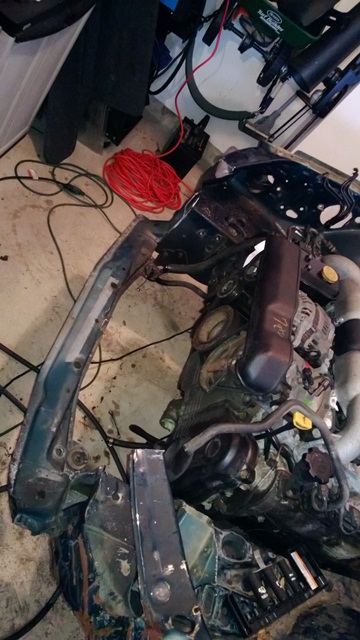

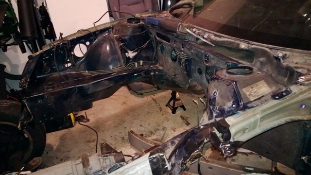

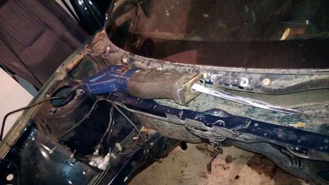

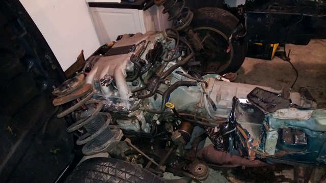

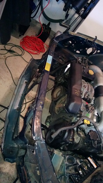

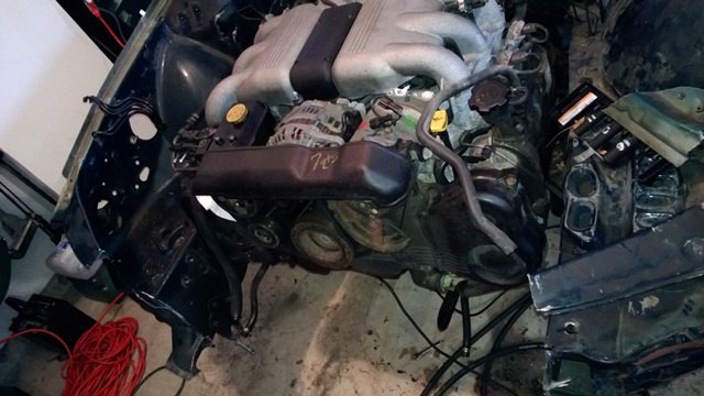

Finally wrestled the engine and trans out...
First I cut the front section out where the radiator was so I could (hopefully) slide it out the front.
Pre-cut look
Top bar cut
Bottom bar cut
There are 6 17mm bolts on either side of the front suspension. It's fairly obvious that they are the front sub section. Then undo the struts, jack the car way up and the engine, trans, etc will allow you to wrestle it out and forward.
The engine naturally leans forward a bit due to the weight but it IS NOT resting on the accessories/drive belt. The oil pan is a roundish shape.
As the saying goes...the sawzall always wins. Godspeed Mr SVX...
By the way make sure to duct tape any sawzall cuts or you will very likely cut yourself badly or at least tear your clothing.
Still have to take out the gas tank and rear diff, but that's not too bad.
