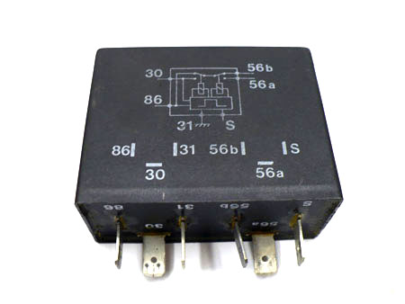

Hi guys,
I installed new lights and a Jwest fuse kit and now my highs are stuck on. The lights worked fine switching high to low prior to the fuse box swap, but I believe it is wired correctly. To start troubleshooting though, I want to swap out relays first before going back into tearing it all apart. Does anyone know of a relay that is available at most auto parts stores/FLAPS that won't break the bank. I know they are available from Pelican, but being in Florida, I'd rather get one locally tonight if possible. I know I can try to find a SAAB one from the junkyard tomorrow, but curious if there is something I can get at a store first. Would one from a later Beetle work? I think NAPA has those. Thanks! -George |

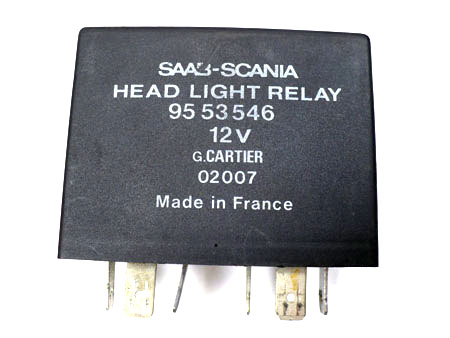

You can also use one of these... $5 on ebay. It needs a power jumper too but these are electronic and do not rely on a mechanical cam like the stock relay does...
This one comes from a Saab but the same relay is common on many European cars. ![]() ![]() |
