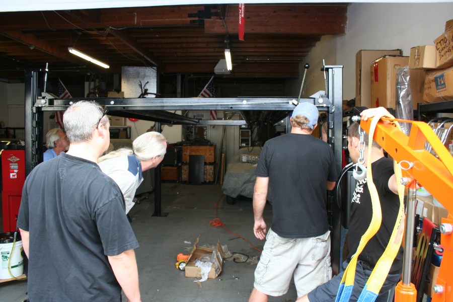

If you have the space for one of these ... I highly recommend them (IMG:style_emoticons/default/biggrin.gif)
