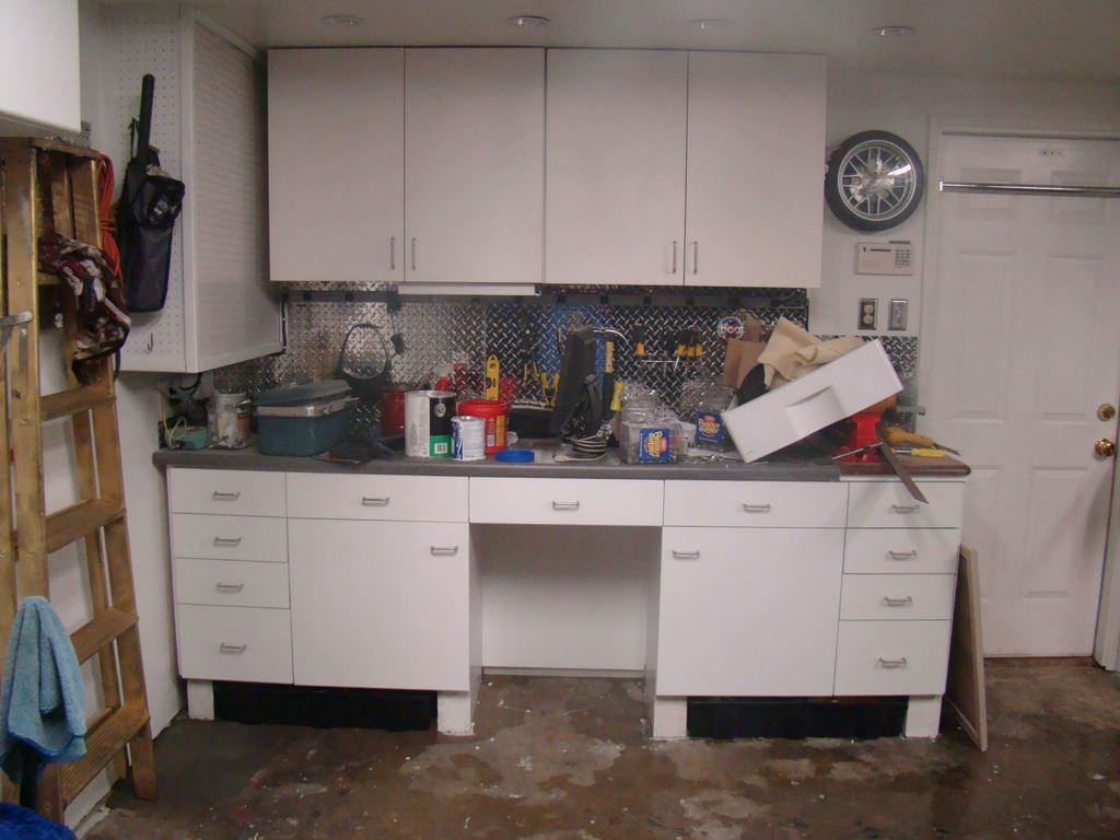

Michelj13
post Jan 9 2013, 09:48 AM
Posts: 83
Joined: 29-May 04
From: Torrance, CA
Member No.: 2,122
Here is mine. A little messy, but surprising what I get done on it (IMG:style_emoticons/default/smile.gif)Attached Image
