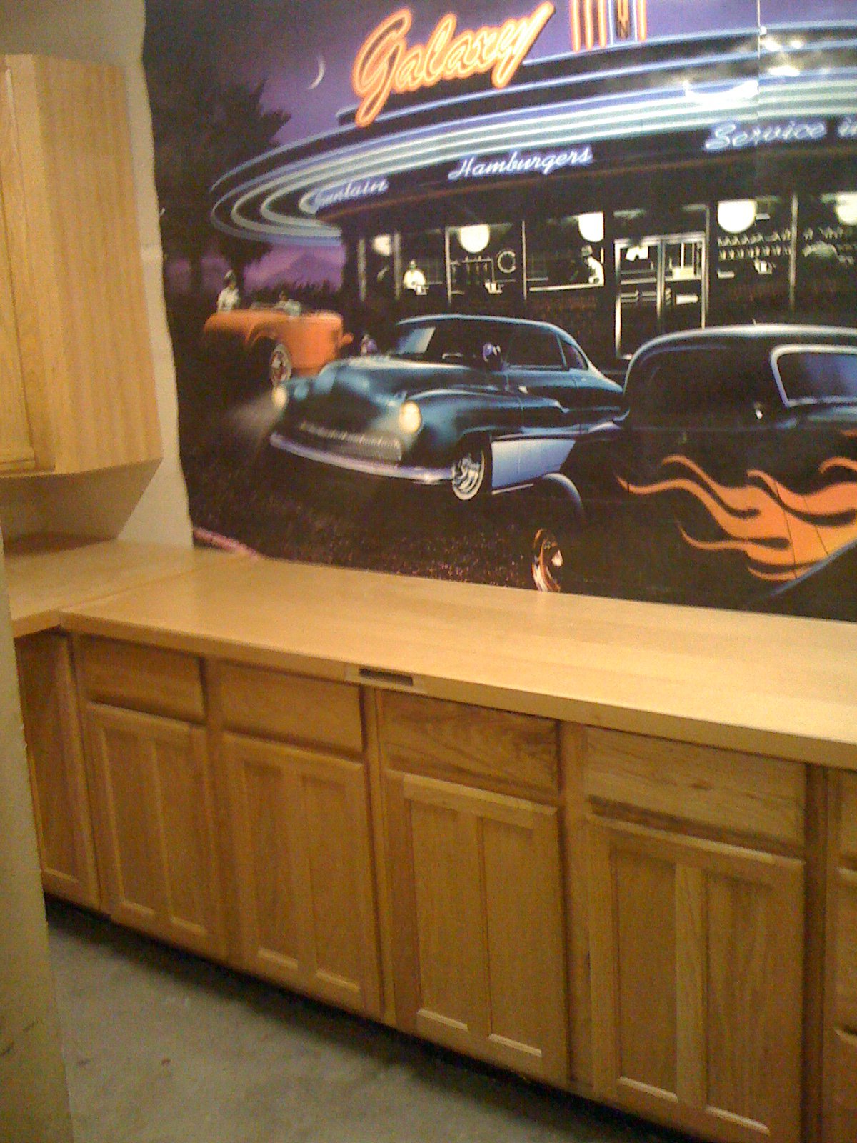

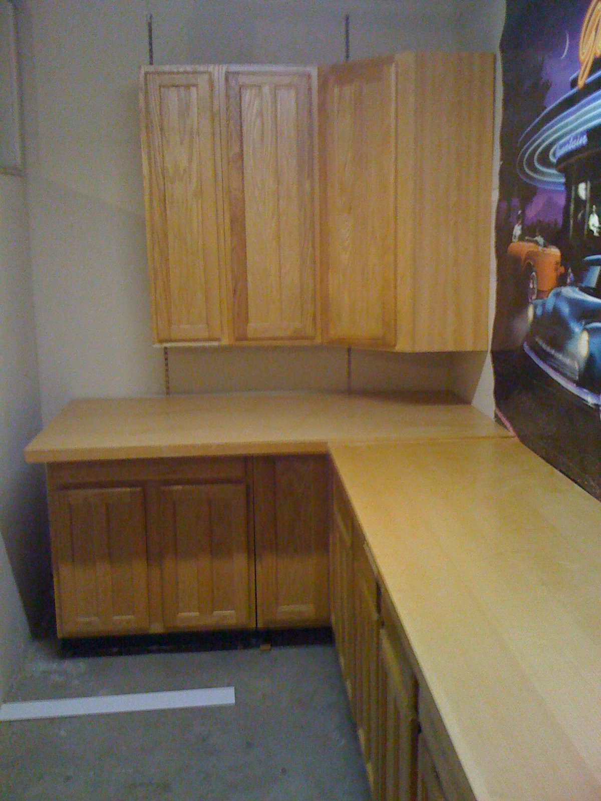

montoya 73 2.0   I needed a desk but wanted a workbench so I built ...   Jan 9 2013, 07:29 PM
