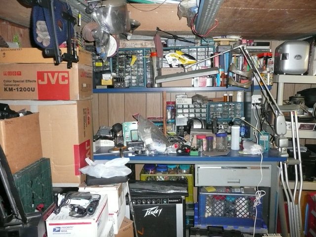

euro911   Long overdue here. Not far behind you, Mike :idea:...   Jan 10 2013, 12:29 AM
stateofidleness   looks like a '78/'79ish Peavey Mace VT Ser...   Jan 10 2013, 12:35 AM
euro911   looks like a '78/'79ish Peavey Mace VT Ser...   Jan 10 2013, 01:08 AM
