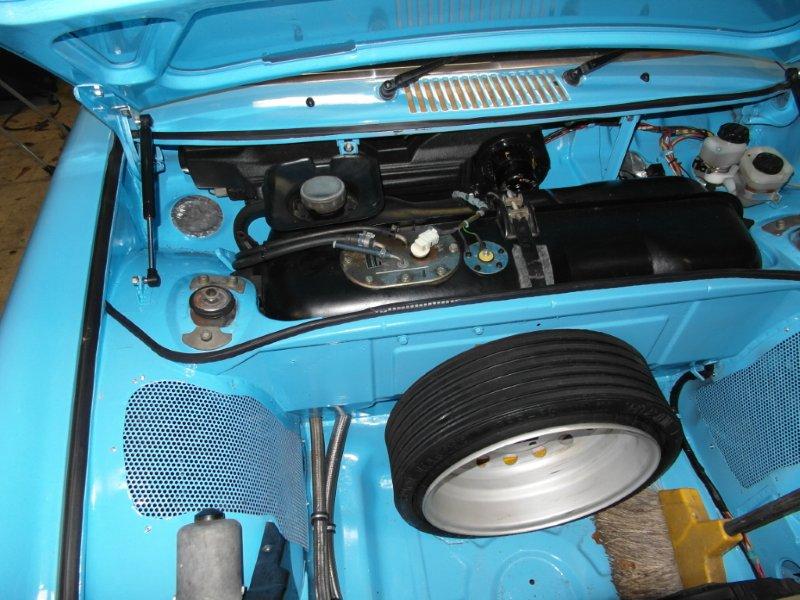

Chris here is a picture of my fuel tank with the intank pump.
You can see the AC evaporater behind the tank fits like a glove. Im working on venting this to the dash vents.

QUOTE(BIGKAT_83 @ Jan 9 2013, 04:29 PM) *
Bob
Sorry to "hijack" but is there any more information about this AC evaporator setup? I've searched everywhere for more info on installing an evaporator where the fresh air box is and can't find much of anything. What brand/model is that evaporator? This is exactly what I want to do with my car eventually.
