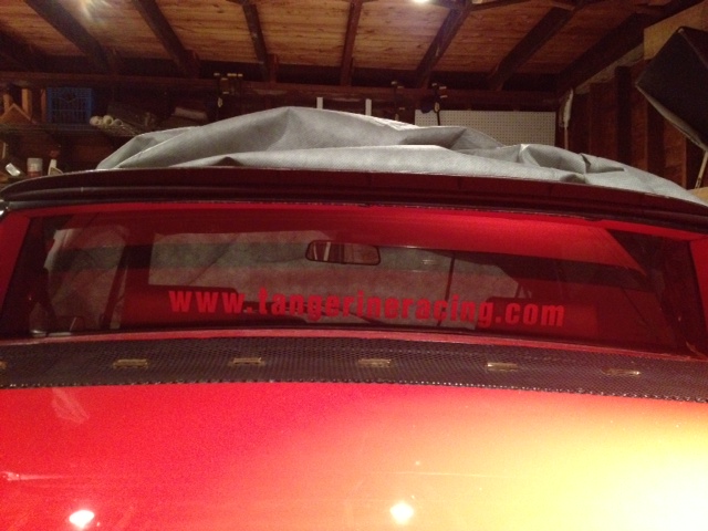

With what seems to be a lot of teeners being rear-ended during the past year, I decided to put an easily removable center-mounted stop light on my car. Turned out pretty well--pretty cheap too--so I thought I would share this.
First, I got a center stop light from a wrecked Volvo V70 (MY 1998-2000), part number 9151490. It was about $10 at the local PnP. I was also able to get about 4+ feet of the wiring harness, which I cleaned up and reused. I picked this light as I'm pretty familiar with Volvo stuff, and had noticed on the road that these were pretty bright, even if I wasn't directly behind them. In taking the light apart (curiosity can be dangerous (IMG:style_emoticons/default/dry.gif) ), I found that the wide viewing angle is due to a couple of clear plastic diffusers. Next step was removing a couple of ribs/mountings from the bottom of the light. I used a rotary tool (dremel?), then sanded it smooth. |

I drive 60 mile per day and its saved my bacon several times. Mine is a pFlaps outside stick on. RN the wires under the trim. Any light is better than no light.
