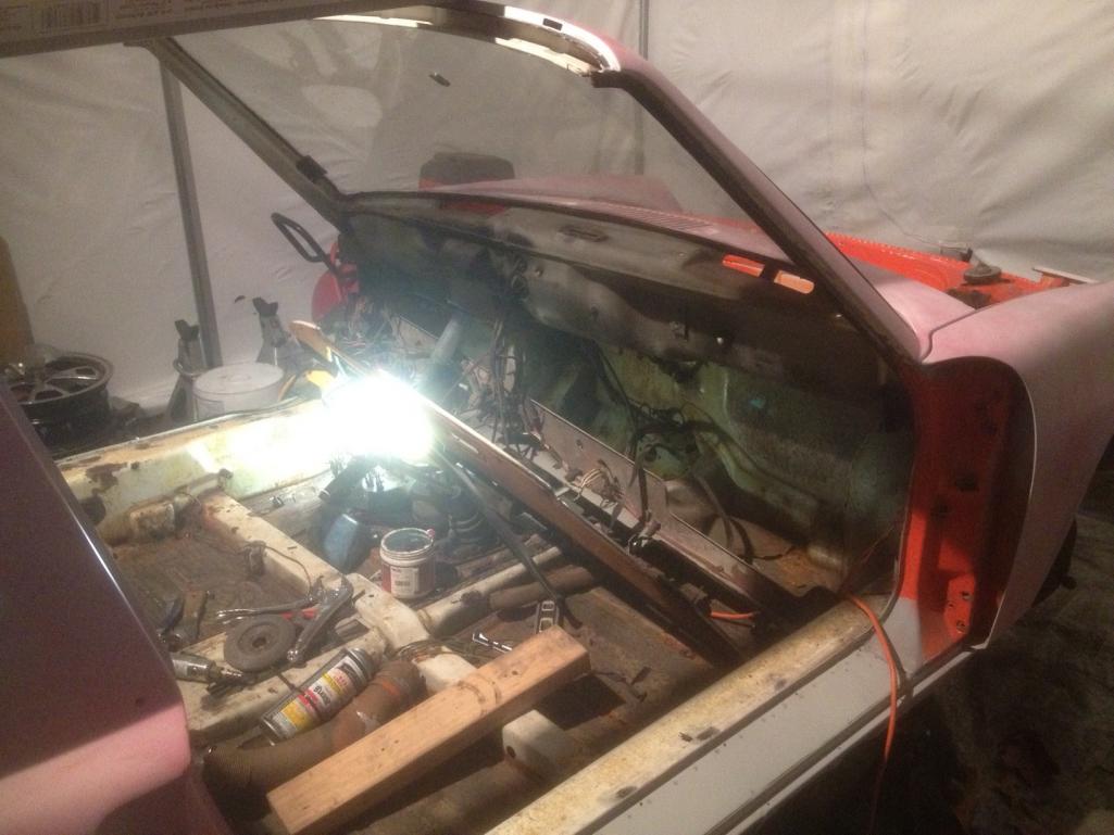

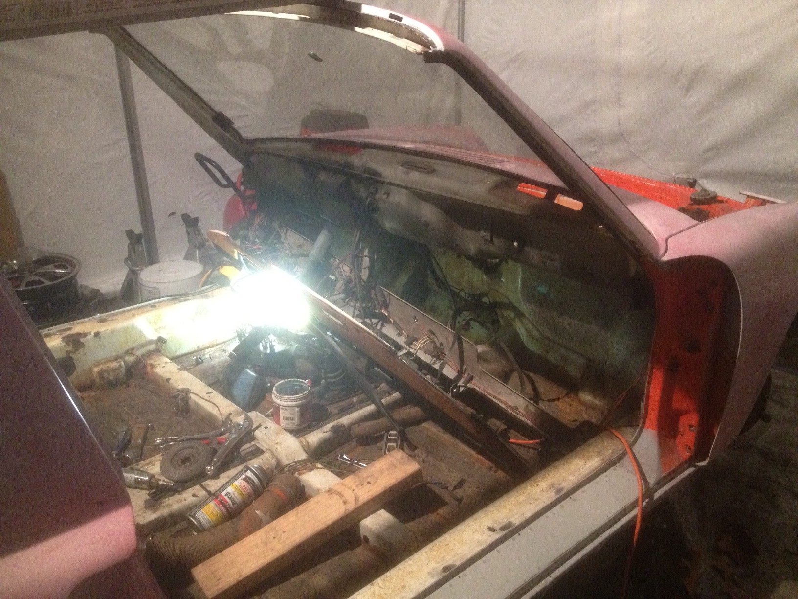

OU8AVW   Got the car all sorted in my workspace and started...   Jan 17 2013, 08:42 AM

OU8AVW   I started to remove the rear trunk pan. Using an a...   Feb 11 2013, 09:03 AM
OU8AVW   So, I just got my replacement panel from Restorati...   Feb 11 2013, 09:12 AM
OU8AVW   Welded on a new engine lid bracket Tore dow...   Feb 15 2013, 05:26 AM
OU8AVW   I had some time this weekend and got the rear trun...   Feb 18 2013, 11:50 AM
