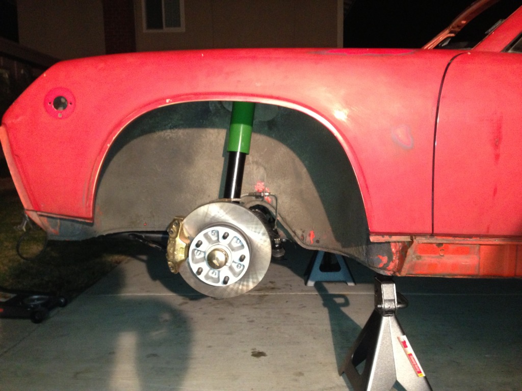

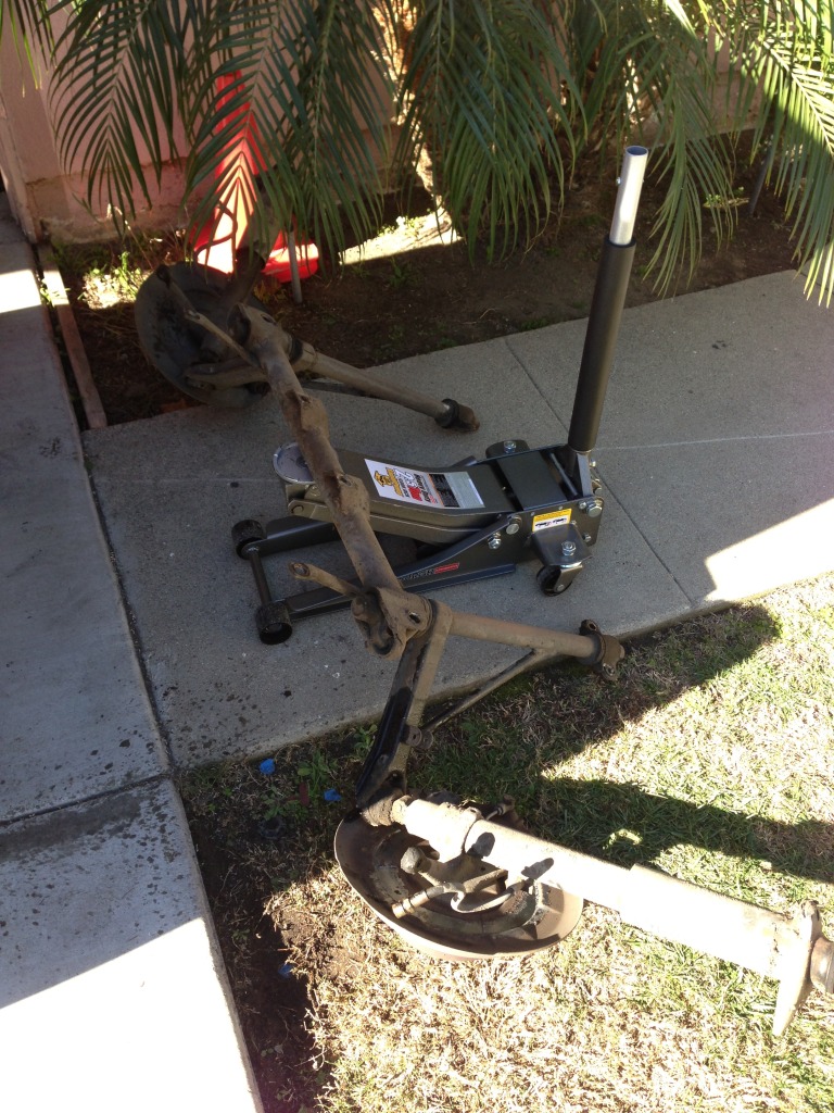

Got the front suspension all swapped! New five lug is on the car with the turbo tie rods, m-calipers and all.
Old one off in one piece
(IMG:http://www.914world.com/bbs2/uploads_offsite/i1293.photobucket.com-14538-1358450381.1.jpg)
New one on! (IMG:style_emoticons/default/biggrin.gif)
(IMG:http://www.914world.com/bbs2/uploads_offsite/i1293.photobucket.com-14538-1358450381.2.jpg)
My question though is about those pressure plates at the upper strut mount. The Haynes book was saying that adjustment of those will alter your steering geometry. So I how do i know it its set up correctly.
Next question is in regards to the torsion bar cap and adjuster screw. Since the car is on jacks right now, its at full droop, so at what angle should those caps start at and should the screw be hitting the top as is or should there be a gap and let it make contact once the car is set down???
I'm going to attempt to get that sheared bolt out of the suspension console tonight, wish me luck!!! (IMG:style_emoticons/default/smash.gif)

oldschool   Got the front suspension all swapped! New fiv...   Jan 17 2013, 03:54 PM
euro911   You'll probably want to take it to an alignmen...   Jan 17 2013, 03:12 PM
