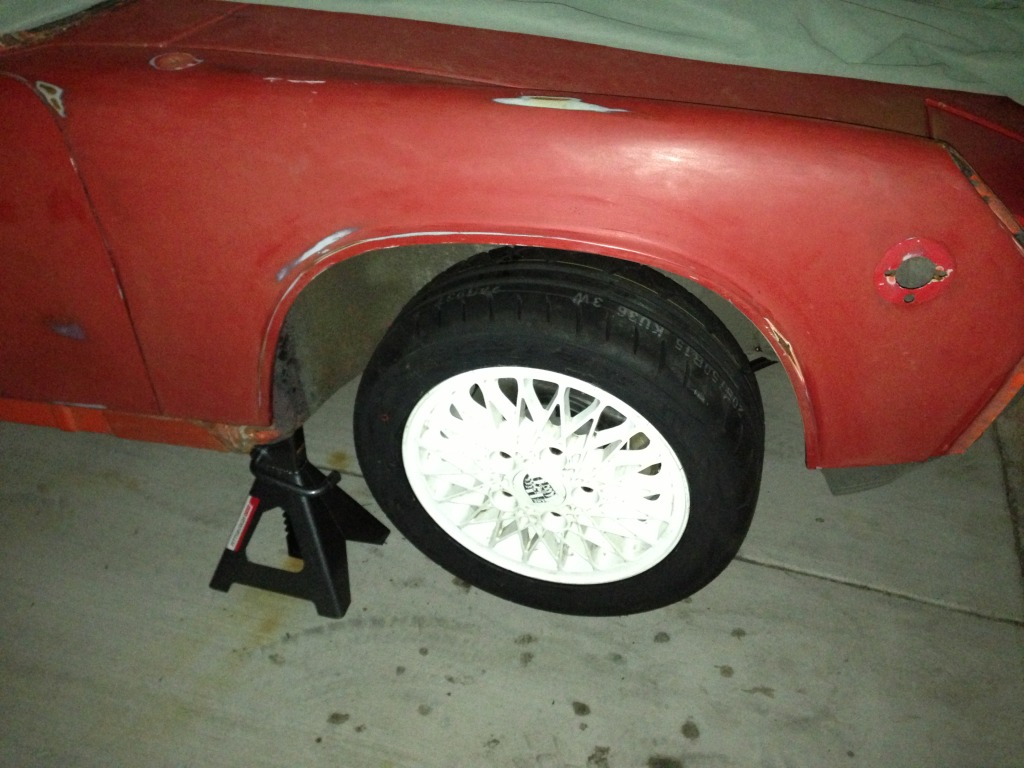

Got some hours loged tonight... did some good things, found some bad, cant complain.
I'll start with the good.
Got one wheel on the front right side. Would have got the left front one on too but then there is the bad, i think one of the lug studs is a little crooked and a tad long, any ideas on getting that situated....?
(IMG:http://www.914world.com/bbs2/uploads_offsite/i1293.photobucket.com-14538-1358498724.1.jpg)
Next I attempted to get that sheared bolt out of the suspension console, was unsuccessful... eventually drilled out the hole trying to spare the threads enough to go over them with a tap and make all better. Drill wasnt perfectly straight so that didnt work... next idea is drill out bigger and tap to an M12
After i got over that situation i went onto the engine bay, drained the gas through the engine compartment fuel lines then removed the stock fuel pump and fuel filter. Will take out the rest of the stock fuel lines and replace with single tunnel SS line for carb set up this weekend.
