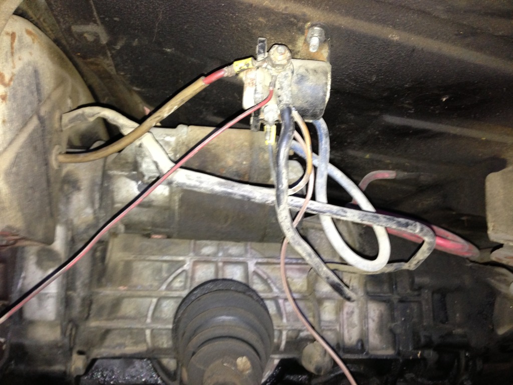

I would like to drop the engine/tran this weekend but have never done this before so any advice would be appreciated.
Prior to that task i am trying to find out where everything is hooked up and what everything is. so i have taken lots of pictures, but i do not know what this is and it doesn't look completely stock, at least some of the wires dont look original so any one know?? One of the larger gauge wires goes directly to the positive terminal of the battery post if that helps.... (IMG:http://www.914world.com/bbs2/uploads_offsite/i1293.photobucket.com-14538-1358549057.1.jpg) (i am referring to the thing with all the cords hooked up to it) Thanks!! |

Kirmizi Your mystery item is a an add-on starter solenoid,... Jan 18 2013, 04:53 PM

dfelz Thanks Mike and Scott for the info on my mystery i... Jan 18 2013, 08:11 PM

Kirmizi Ultimately, you'll have to determine if the ca... Jan 18 2013, 08:34 PM
dfelz Ok thanks Mike, I think I will initially leave it ... Jan 19 2013, 02:14 PM
