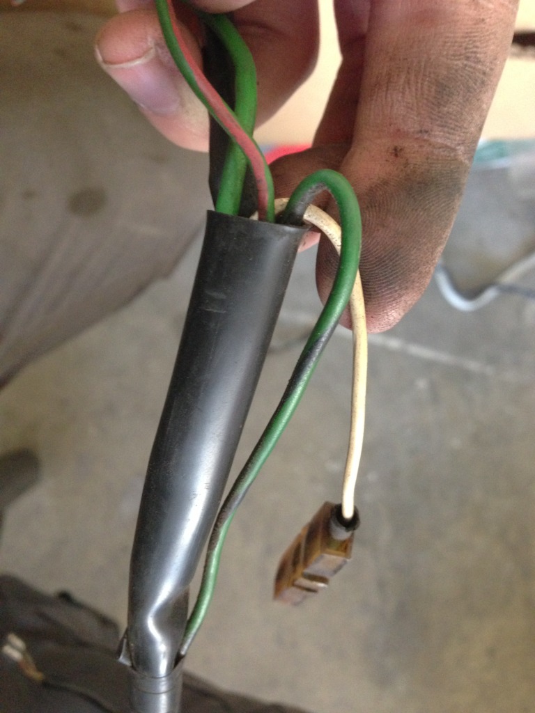

Next wiring question.
On the 12 pin relay board harness, what is the white cable labeled Aux Air Valve?
There is also a green with black stripe wire separating from the harness near the starter coil wires that was taped down by the PO, and its not on the relay board diagram. Anyone know what that is for?
Shown in the picture are both the wires i am referring to

3d914   Next wiring question. On the 12 pin relay board ...   Jan 19 2013, 07:28 PM
dfelz   Next wiring question. On the 12 pin relay board...   Jan 19 2013, 09:42 PM
Kirmizi   Try looking here for your specific wiring diagram:...   Jan 19 2013, 07:00 PM
euro911   Correct. You gonna be home tomorrow? ... I can br...   Jan 19 2013, 09:54 PM
