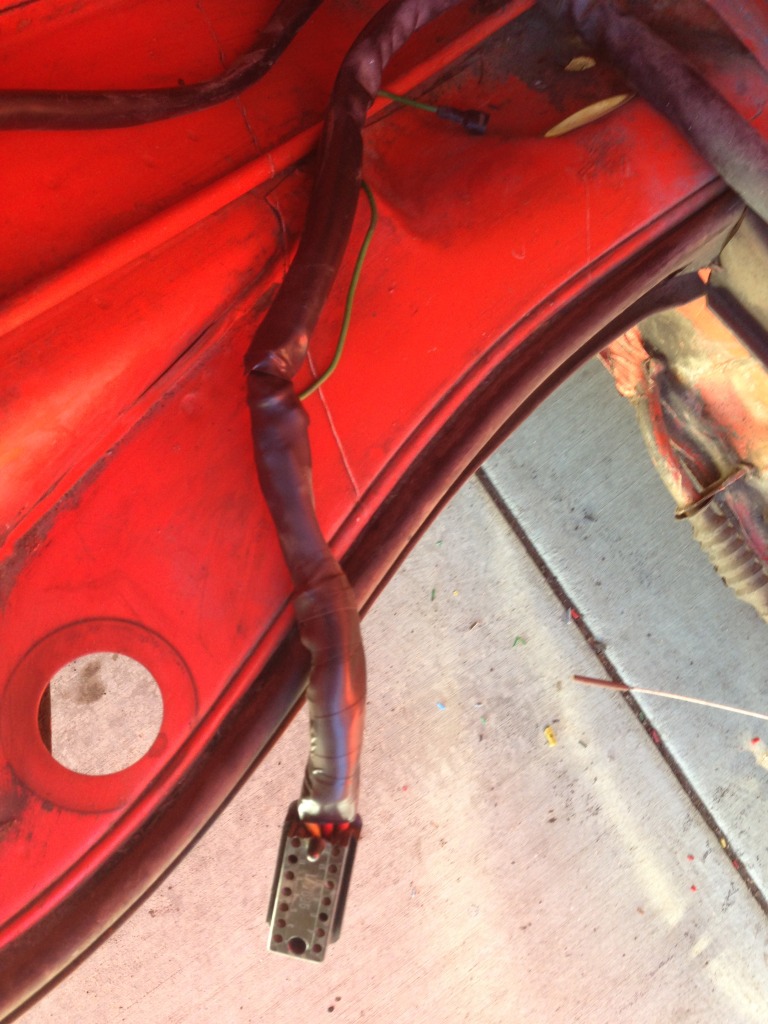

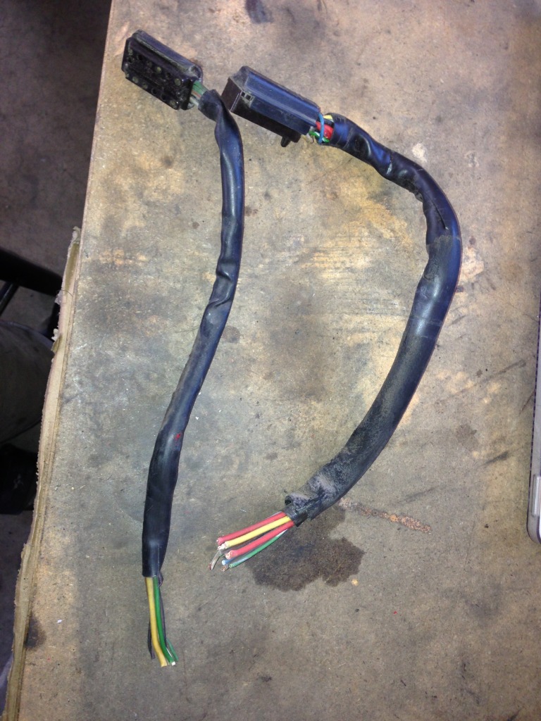

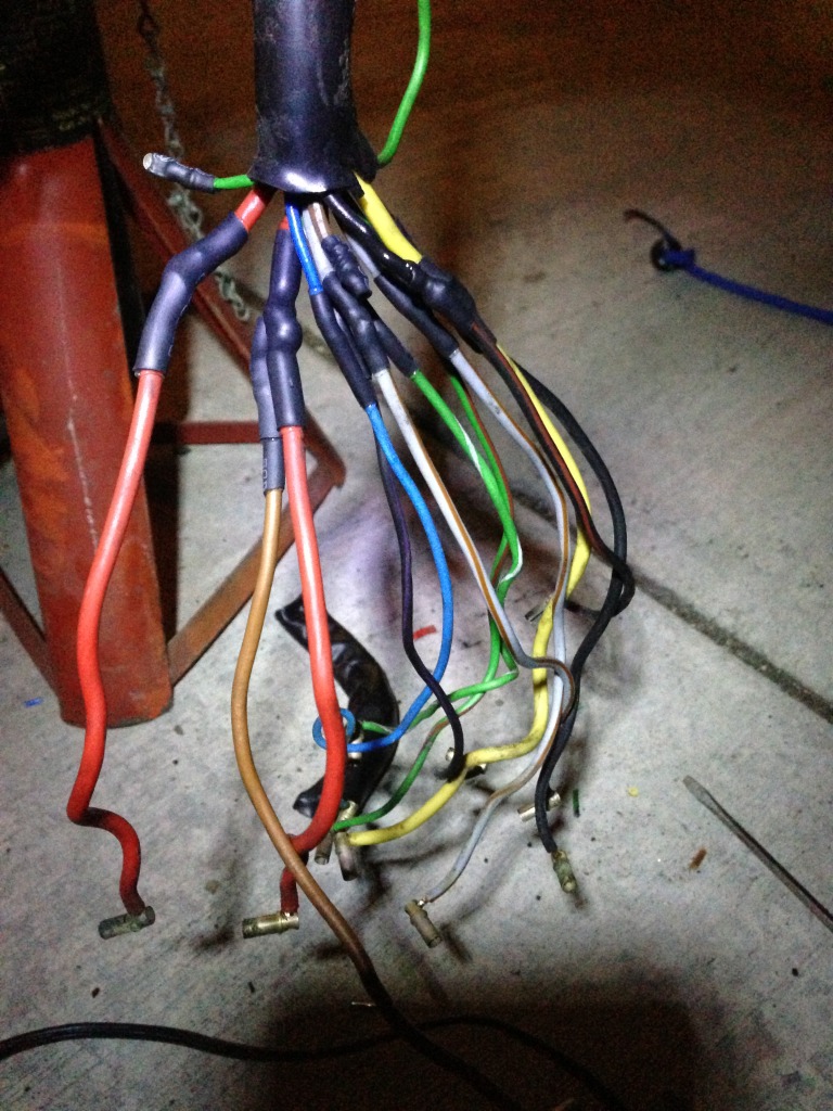

Alright! So yesterday i messed around with some of the wiring harnesses. The 71 had the ends cut off so sliced them off the 72 and soldered and heat shrink tubed all the individual wires together.
CUT
(IMG:http://www.914world.com/bbs2/uploads_offsite/i1293.photobucket.com-14538-1358731498.1.jpg)
PASTE
(IMG:http://www.914world.com/bbs2/uploads_offsite/i1293.photobucket.com-14538-1358731499.2.jpg)
ORGANIZE
(IMG:http://www.914world.com/bbs2/uploads_offsite/i1293.photobucket.com-14538-1358731499.3.jpg)
After that hooked it up to the relay board and plugged in the battery to do some minor test. Both headlights were put in and work fine, taillights work, flashers work, fuel sender works (but is week, need to tidy up the solders at the plug), the left turn signal works but the right is not quite working. when i flip the lever up for right turn signal is clicks once and then nothing. If i held the lever in the middle right before it would go to the staying up position, it would stay on.... any ideas.

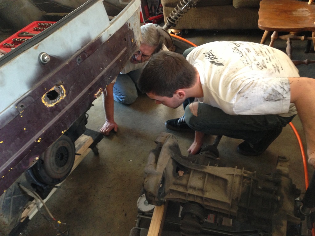

Now moving on to some more exciting shit, Mark (euro911) came over today and we got the engine out of the 72!! (IMG:style_emoticons/default/piratenanner.gif)
(IMG:http://www.914world.com/bbs2/uploads_offsite/i1293.photobucket.com-14538-1358731499.4.jpg)
Now me and my roommate are going to pull valve covers off and see if we can find a source of the knocking we heard when it ran for 1 minute last week. if nothing we will proceed to the head and pull that sucker off...
