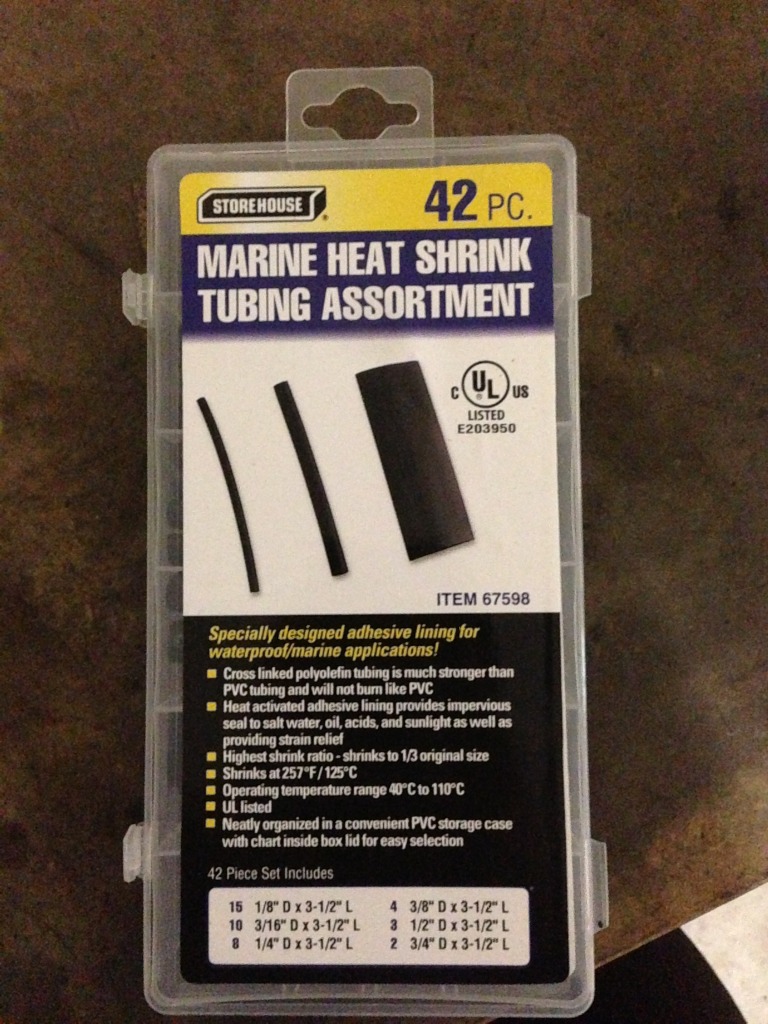

Hey David, I noticed that the heat shrink on your splices have glue inside. The glue is part of the tube right? Where did you get it? Locally?
Ya they are the best heat shrink tubes, they release an adhesive/sealant when heated up. I got a variety pack/container from HF, only cost about $5 for a 42pc set.
(IMG:http://www.914world.com/bbs2/uploads_offsite/i1293.photobucket.com-14538-1358748456.1.jpg)
