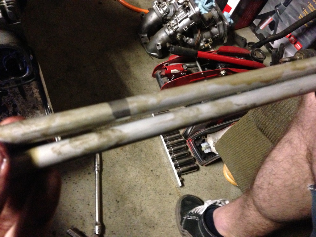

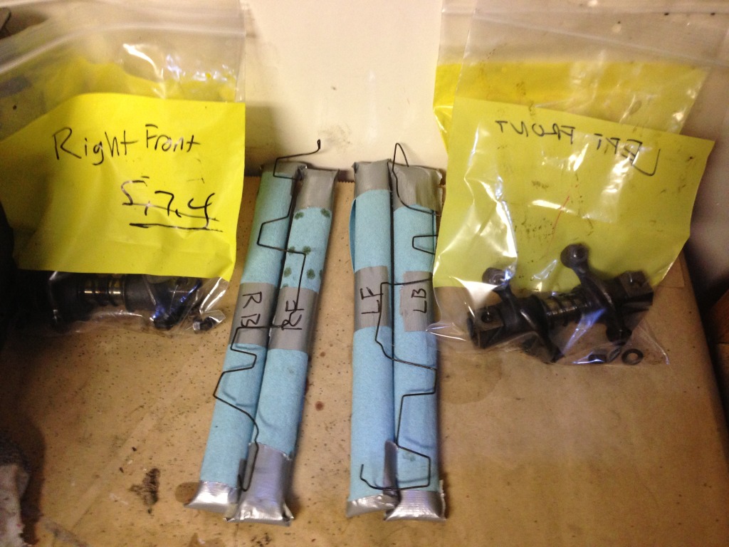

Thats ok! I need a set anyways, me and grant got the valve covers off and removed the rockers and pushrods, everything in there looked really good, only one blemish on one of the pushrods. Need everyones opinion on it. Its flush with the rest, just dulled in color....
(IMG:http://www.914world.com/bbs2/uploads_offsite/i1293.photobucket.com-14538-1358749592.1.jpg)
Heres all of the rockers and push rods out, bagged, and labeled. Will do more engine work tomorrow.
(IMG:http://www.914world.com/bbs2/uploads_offsite/i1293.photobucket.com-14538-1358749593.2.jpg)
