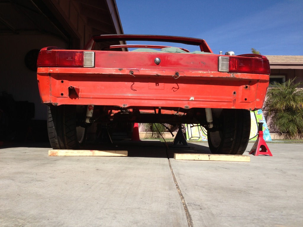

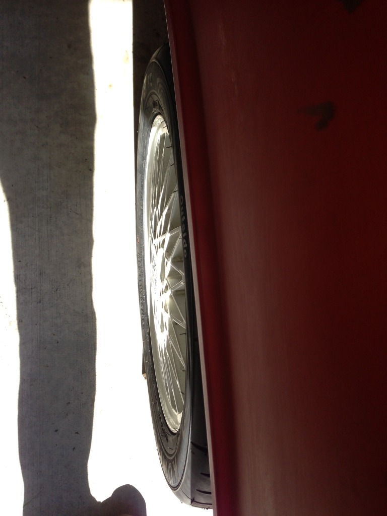

Got the Rear wheels on! she's half way to being able to roll around. fitment with stock fenders and 205 tires is gonna be close (IMG:style_emoticons/default/biggrin.gif) but i think it will fit just perfectly. Will be flaring front and rear eventually anyways.
(IMG:http://www.914world.com/bbs2/uploads_offsite/i1293.photobucket.com-14538-1358884847.1.jpg)
(IMG:http://www.914world.com/bbs2/uploads_offsite/i1293.photobucket.com-14538-1358884848.2.jpg)
