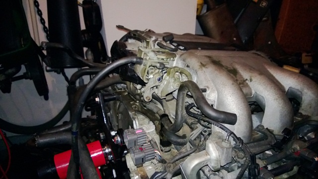

So the angle of the intake has gotten my attention. Bob and I spoke of flipping it which can be done but might require rearranging of the alternator.
When you look at it from the top it looks like it will clear since the angle is so steep....
But under the intake snorkels is this little guy which will probably make it harder. I suppose a spacer could work...we'll see. Otherwise the alternator could be moved...

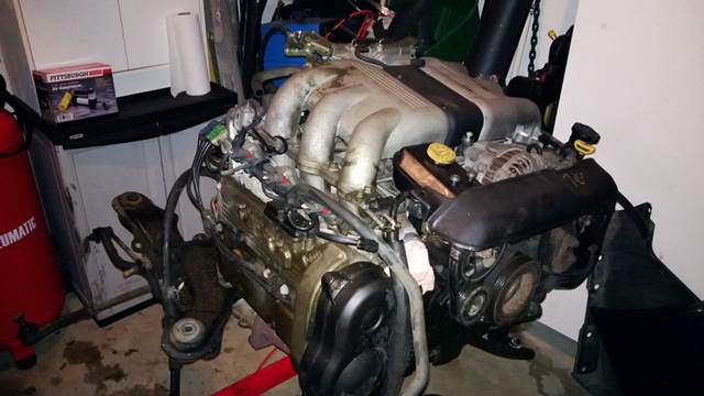

Chris H.   Happy New Year everyone! Just a bit more pr...   Jan 1 2013, 04:38 PM
Chris H.   Finally wrestled the engine and trans out... Firs...   Jan 2 2013, 06:55 PM

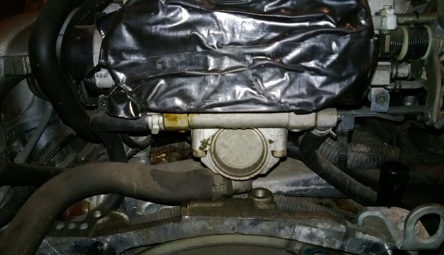

Chris H.   Here's a better shot of the angle... And t...   Jan 23 2013, 06:54 AM
76-914   Chris, what is the issue with the TB and Alt? I di...   Jan 23 2013, 08:11 AM
Chris H.   Sorry what I was saying is that it appears that I ...   Jan 23 2013, 10:27 AM
scotty b   If you flip it, will you still have enough room to...   Jan 23 2013, 04:51 PM
wingnut86   94' had an EGR valve in the location under the...   Jan 23 2013, 09:12 PM
Chris H.   Sorry guys I was out for a couple of days... wing...   Jan 25 2013, 10:10 AM
BIGKAT_83   Its the Idle Air Control valve.... You need this i...   Jan 25 2013, 11:36 AM
Chris H.   Well there you go...that thing is not going anywhe...   Jan 25 2013, 12:31 PM
