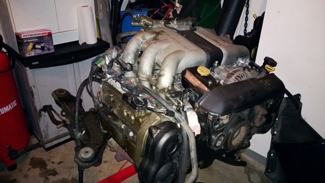

Chris H.   Just some minor updates...the exciting stuff will ...   Jan 23 2013, 06:44 AM

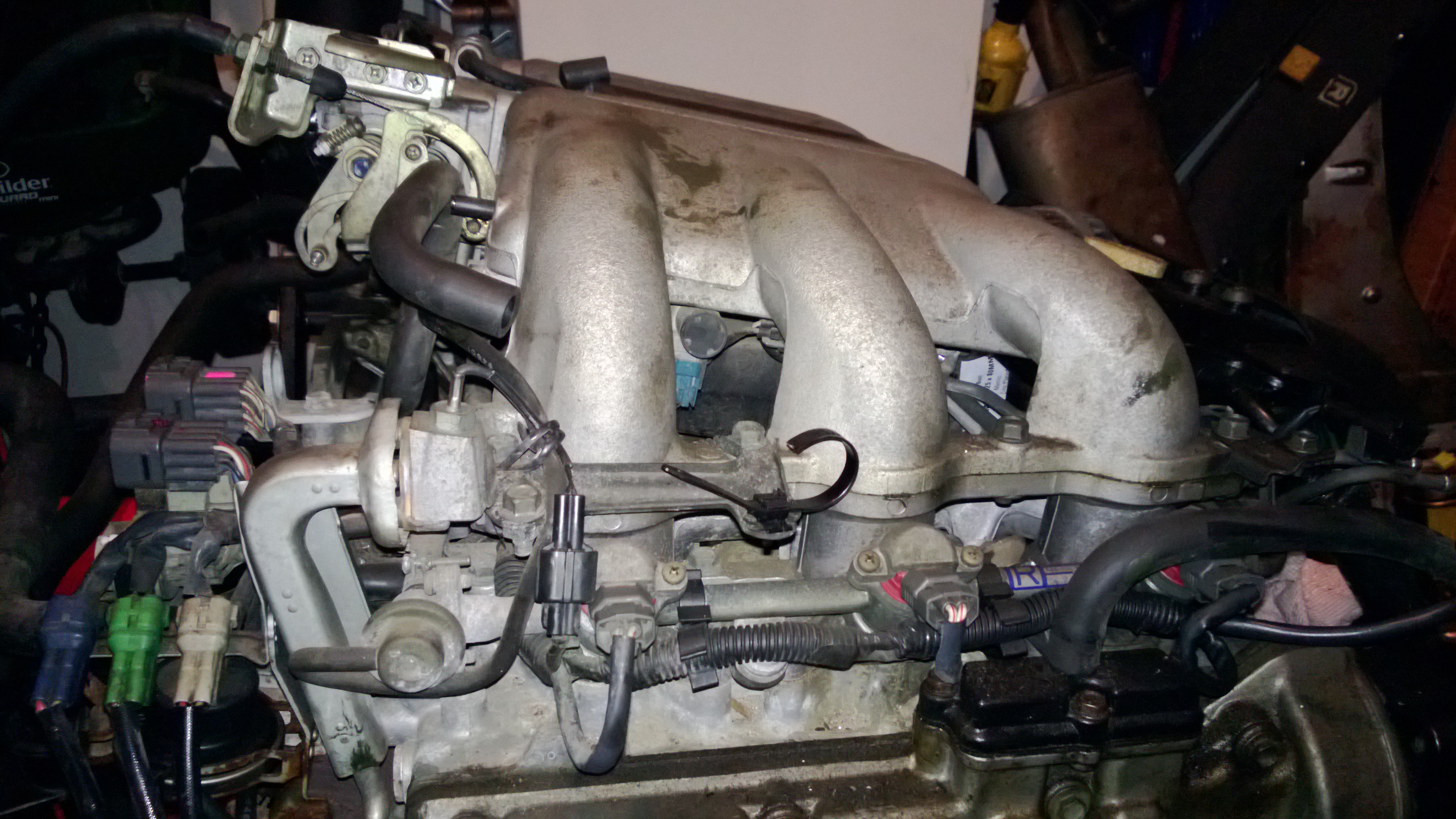

Chris H.   So the angle of the intake has gotten my attention...   Jan 23 2013, 06:44 AM
Chris H.   Here's a better shot of the angle... And t...   Jan 23 2013, 06:54 AM
76-914   Chris, what is the issue with the TB and Alt? I di...   Jan 23 2013, 08:11 AM
Chris H.   Sorry what I was saying is that it appears that I ...   Jan 23 2013, 10:27 AM
scotty b   If you flip it, will you still have enough room to...   Jan 23 2013, 04:51 PM
wingnut86   94' had an EGR valve in the location under the...   Jan 23 2013, 09:12 PM
Chris H.   Sorry guys I was out for a couple of days... wing...   Jan 25 2013, 10:10 AM
BIGKAT_83   Its the Idle Air Control valve.... You need this i...   Jan 25 2013, 11:36 AM
Chris H.   Well there you go...that thing is not going anywhe...   Jan 25 2013, 12:31 PM
