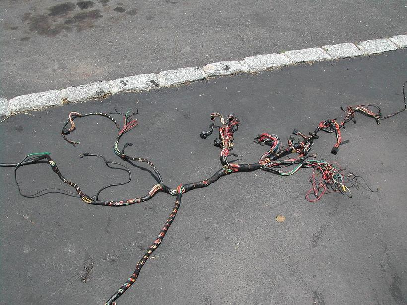

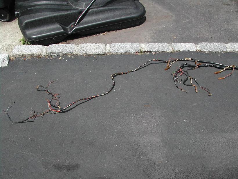

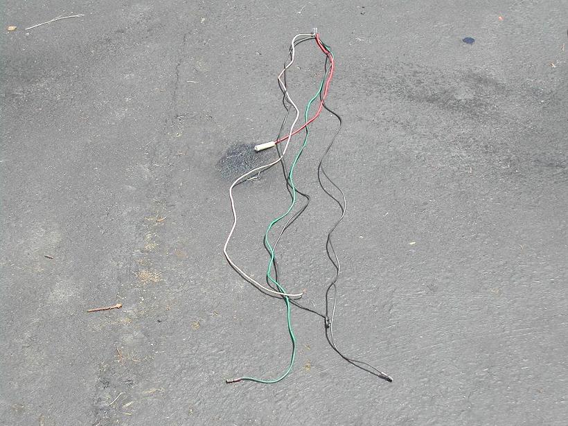

i need your help..i just got a wiring harness in the mail...and im trying to identify all the parts...i did a little..but i couldnt get far..im not very good at reading the wiring diagrams
so i took pictures of each part and im hoping you guys could possibly tell me where they go
i really appreciate all the help i can get

Dave_Darling   Step 1--buy yourself a Haynes manual and turn to t...   Jun 24 2004, 09:52 AM
SirAndy   yupp, will help. i need to go and get breakfast fi...   Jun 24 2004, 10:21 AM
SirAndy   ok, before i go into more detail, what year is you...   Jun 24 2004, 01:38 PM
SirAndy   rear first ... NOTE: where is says "fuel pump & o...   Jun 24 2004, 01:59 PM
SirAndy   fuel injection harness, others may chime in here, ...   Jun 24 2004, 02:06 PM
SirAndy   main section ...   Jun 24 2004, 02:16 PM
SirAndy   and the front ...   Jun 24 2004, 02:34 PM
Jeff Bowlsby   You are phenominal Andreas...   Jun 24 2004, 02:38 PM
SirAndy   a few tips about installation: the whole harness ...   Jun 24 2004, 02:41 PM
