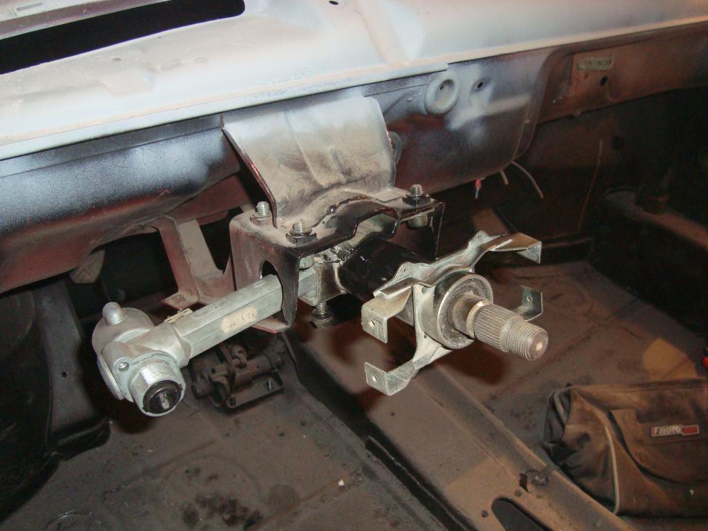

Start with a 4 cylinder column. Remove the mounting plate from it.
Pict is of the leftover column tube. (IMG:style_emoticons/default/sawzall-smiley.gif)
Now you have just the column mounting plate.
Remove the mounts from the 911 column, saving the tube. (IMG:style_emoticons/default/sawzall-smiley.gif)
Weld the 4 cylinder mount to the 911 column. (IMG:style_emoticons/default/welder.gif) You should end up with this.
Now you can put the column back together. I don't know about a car with a stock 3 gauge dash, but with the 911 style dash I had to trim the front edge of the top clamshell to get it to clear the gauge assembly.

After scouring the archives I have found this one to be the easiest. I had the 911 column and was given a switch both out of a SC. No offense to anyone who has tackled this and thought there was was better. I basically read several and took bits and pieces of infor from many of them. The hardest part was cutting the old mount from the 4 cylinder column. (IMG:style_emoticons/default/sawzall-smiley.gif) Then a little (IMG:style_emoticons/default/welder.gif) and you got it!!
I love it that all you guys who have blazed the trails before me! (IMG:style_emoticons/default/first.gif) It makes it much easier for the rest of us!! (IMG:style_emoticons/default/pray.gif) One thing I would add is that before you weld everthing up align the notches in the steering shafts with the universal joint to make sure you have your mounting plate in the right location. I know it seems elementary but know this ahead may save you time and keep you from screwing it up :-) I know my car is already tore apart but it took little time to do this.
