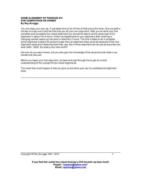

I have been talking to Ray Scruggs and he sent me his pdf file on how to home wheel align a 914. He said he didnt mind if I posted it up here for us. Which was pretty cool of him I thought. But I don't know how to post it. If you know how, pm me and I will email it to you.

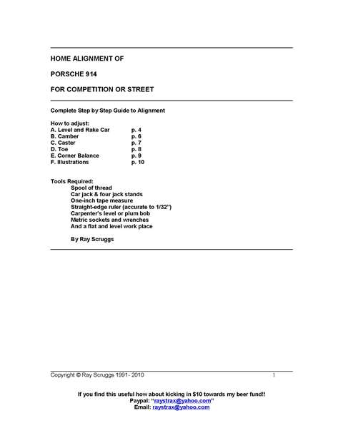

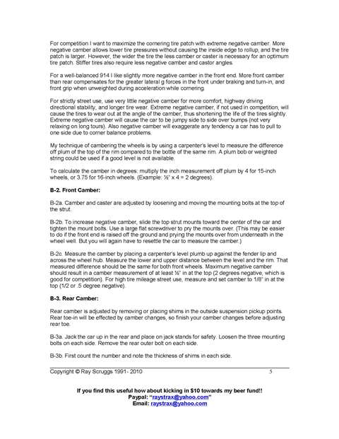

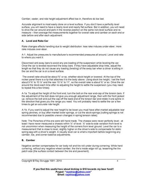

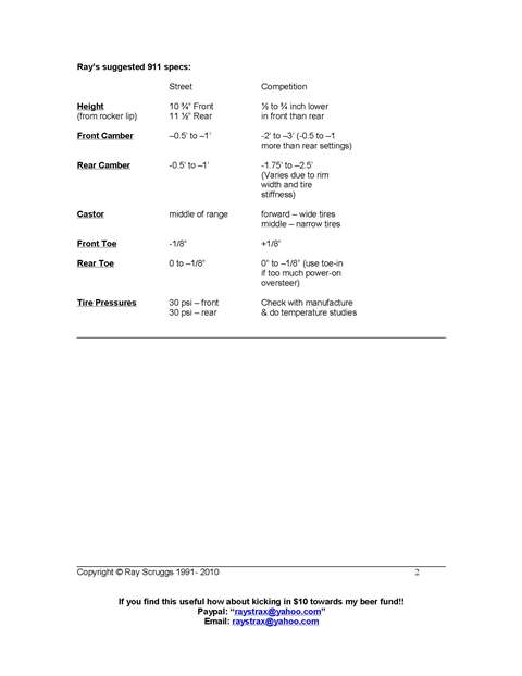

rmital   original PDF images:   Jan 25 2013, 07:33 AM
rmital   more:   Jan 25 2013, 07:35 AM
rmital   figures:   Jan 25 2013, 07:37 AM
