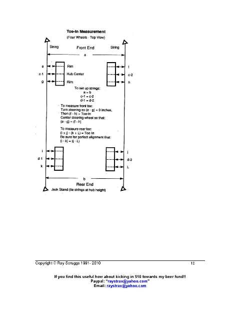

strawman   I've used string alignment setups for years fo...   Jan 24 2013, 09:33 PM
mrbubblehead   That is a fantastic right up strawman! Thanks ...   Jan 24 2013, 09:50 PM
strawman   what keeps them attached to the car when you move...   Jan 24 2013, 10:00 PM

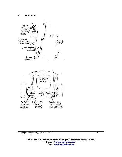

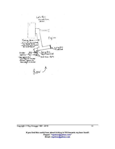

rmital   original PDF images:   Jan 25 2013, 07:33 AM
rmital   more:   Jan 25 2013, 07:35 AM
rmital   figures:   Jan 25 2013, 07:37 AM
Eric_Shea   Just amazing. Thanks! Is the rear any differ...   Jan 25 2013, 11:06 PM
strawman   Is the rear any different? The rear verticals a...   Jan 25 2013, 11:34 PM
