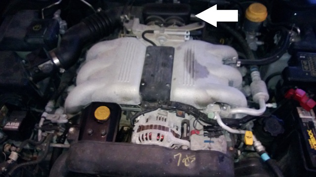

wingnut - It's a 95....could be the EGR...
Scotty - That's a very good question...I think it will fit but we'll find out very soon. The stock breather box adds a couple of inches to the end of the intake and then exits to the left passenger side like this:
Sorry for the grainy photo. Let me know if you need any measurements when you start your install. I'll keep you posted.
