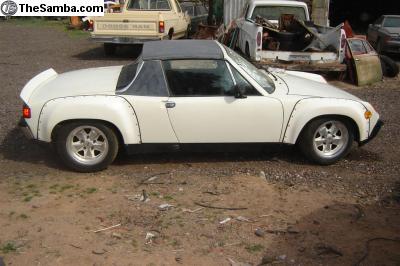

I like the look (and ease of replacement) of the bolted-on GT flare. Does anyone have detailed (up-close) pics of this treatment? What size/number/type of screws or bolts were used.
Please post pics

Gint   The white one is Scott Schroeder's car. He...   Dec 16 2003, 11:15 AM
BravoHotel   Scott, Can you give us details? BH   Dec 16 2003, 11:16 AM
Ferg   more pic's of scott's car here http://gal...   Dec 16 2003, 11:17 AM

Scott Schroeder   Hi All - I unfortunately do not have pics on my of...   Dec 17 2003, 11:12 AM
Scott Schroeder   Here is the tops - kind of a distant pic. More ton...   Dec 17 2003, 11:14 AM

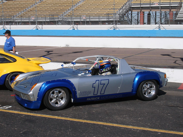

bulitt   Just wanted to add a pic of Tony (cracker) car. h...   Apr 2 2013, 03:08 AM

BKLA   track day rivet flares - Rivets from Pegasus racin...   Apr 8 2014, 05:57 PM
iamchappy   track day rivet flares - Rivets from Pegasus raci...   Apr 8 2014, 07:15 PM
