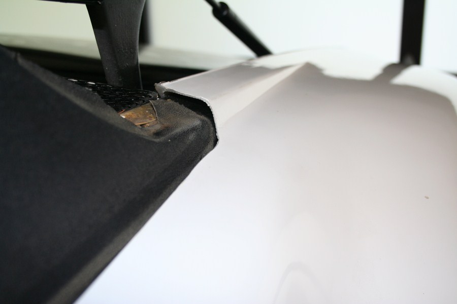

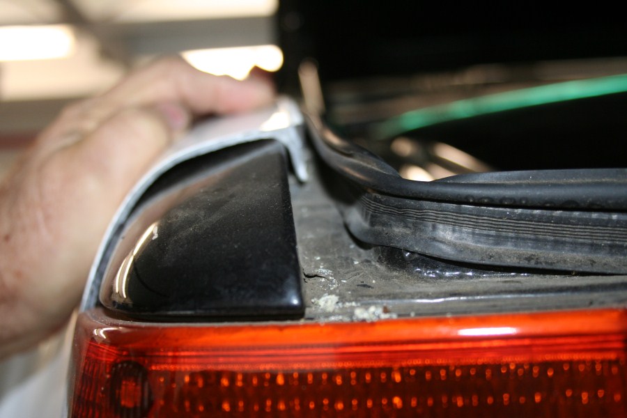

I don't think it matters much who you buy fiberglass from. Just resign yourself that it will take some work. I sent these pics to Jeff at QRS Fiberglass. Waiting for a call. Looks like some major trimming to do.

Woody   I bought all of my glass from rennspeed. The front...   Jan 25 2013, 06:35 PM
Elliot Cannon   I don't think it matters much who you buy fibe...   Jan 25 2013, 07:59 PM
Woody   I don't think it matters much who you buy fib...   Jan 25 2013, 08:06 PM
