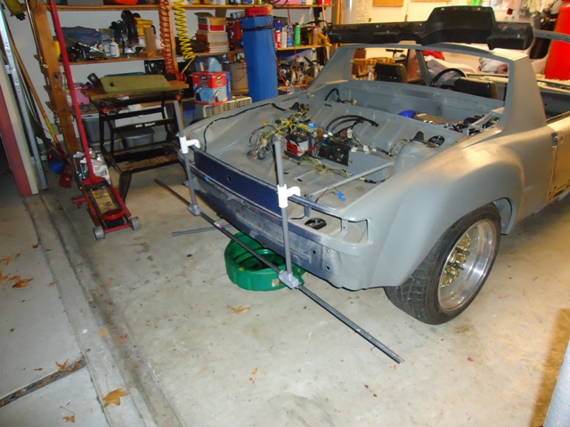

First up is the front setup on the front of my car:
Just amazing. Thanks! Is the rear any different?

QUOTE(Eric_Shea @ Jan 25 2013, 09:06 PM) *
The rear verticals are longer, and the fore/aft is shorter. See the pic below. Hope this helps!
