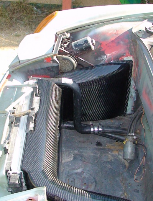

Chris H.   BIGKAT and I were talking radiators last week. Si...   Jan 26 2013, 02:32 PM
scotty b   The wheel well cutting is definitely an area to be...   Jan 26 2013, 03:51 PM
DBCooper   Give it a go. I think that area works because it...   Jan 26 2013, 04:42 PM
