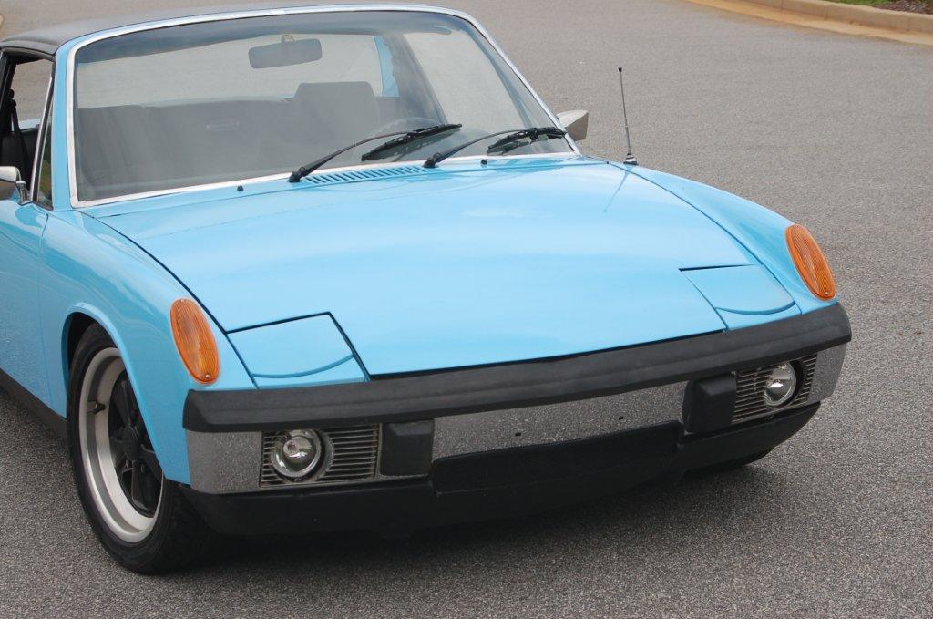

That's what BIGKAT did (with just the GT opening), and it apparently worked well:
(IMG:http://www.914world.com/bbs2/uploads/post-194-1340590465.jpg)
My radiator opening is just a few square inches larger than what I measure the GT opening to be:
(IMG:http://www.914world.com/bbs2/uploads_offsite/i255.photobucket.com-2618-1269561145.1.jpg)
I only have a 2.0 liter turbo in mine, with the Renegade radiator, and it's never been hot in summertime south Texas or the California desert. The fans have come on when I've been thrashing it and then pull into stop and go traffic, but the needle's never moved. Air for both the radiator and intercooler go through that opening.
That radiator opening was cut into a painted bumper to test the size hole I'd need. I cut it small and was going to keep opening it up till it was large enough to cool well, but that's still the original "small" hole because I never had to enlarge it. I just bought a narrow body GT valance and now I'll cut the chrome bumper to match the GT valance, knowing that opening will be large enough. I believe BIGKAT had a big 3.3 liter six in his, so should work for that motor as well. I don't know this for a fact and it seems counter-intuitive, but I think radiator capacity and the air exits from the trunk are more critical than the size of the inlet.
