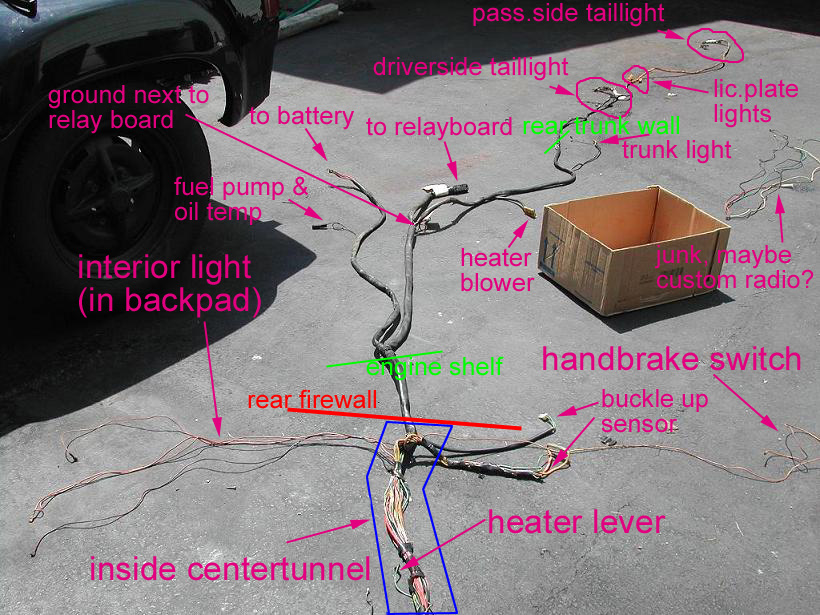

i need your help..i just got a wiring harness in the mail...and im trying to identify all the parts...i did a little..but i couldnt get far..im not very good at reading the wiring diagrams
so i took pictures of each part and im hoping you guys could possibly tell me where they go
i really appreciate all the help i can get

rear first ...
NOTE: where is says "fuel pump & oil temp" it seems the fuel pump wires are missing, in one of the other pictures, it only shows the green oil temp wire !!!!

SirAndy   rear first ... NOTE: where is says "fuel pump & o...   Jun 24 2004, 01:59 PM
SirAndy   fuel injection harness, others may chime in here, ...   Jun 24 2004, 02:06 PM
SirAndy   main section ...   Jun 24 2004, 02:16 PM
SirAndy   and the front ...   Jun 24 2004, 02:34 PM

SirAndy   a few tips about installation: the whole harness ...   Jun 24 2004, 02:41 PM
