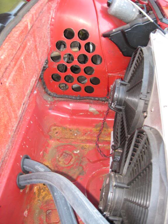

Give it a go. I think that area works because it's low pressure, and if that's so it should suck hot air out through louvers, lots of small holes (like mine), or one big one.
My outlet, done with a template (so both sides are identical) and a hole saw, so it still retains some strength. I don't drive it in the rain (California) so it works for me.
(IMG:http://www.914world.com/bbs2/uploads_offsite/i379.photobucket.com-2618-1359240141.1.jpg)
