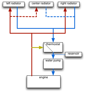

I would like to make a two radiator system like the 911s. If there was a way to intake behind the doors and exhaust some place aft of that in a way that keeps the looks and functionality, then I would be all over that.

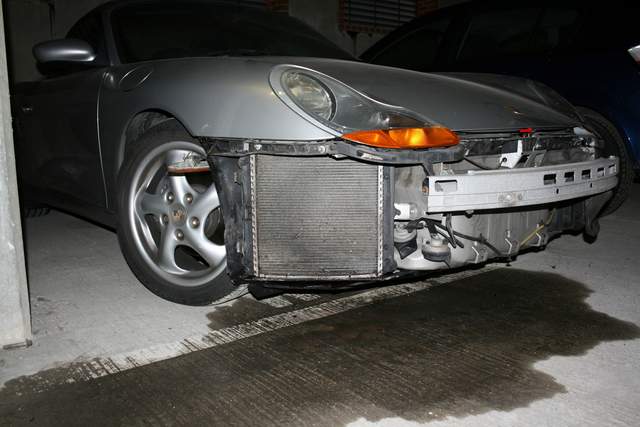

QUOTE(Dr Evil @ Jan 26 2013, 03:03 PM) *
Porsche uses both a 2 and 3 radiator setup but it's not in the engine compartment. it's in the front bumper and exits air into the fender wells. Not unlike a water cooled 914.
