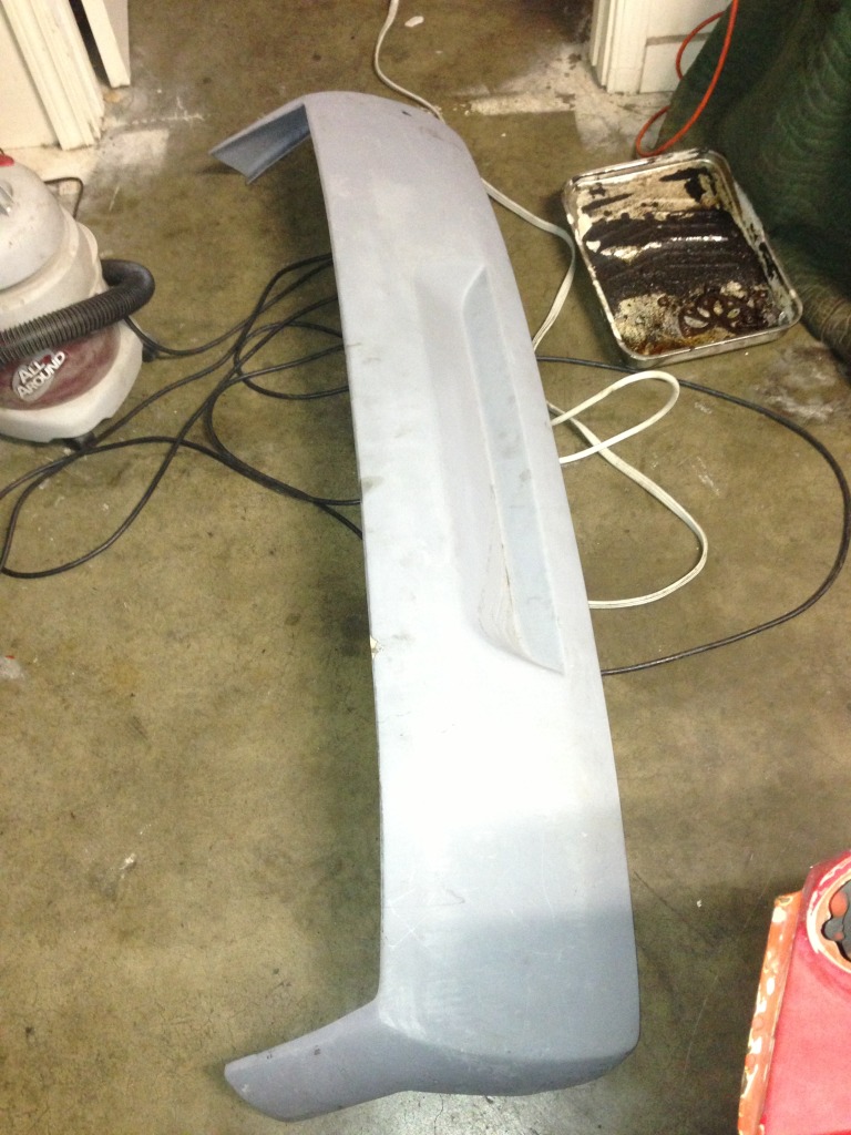

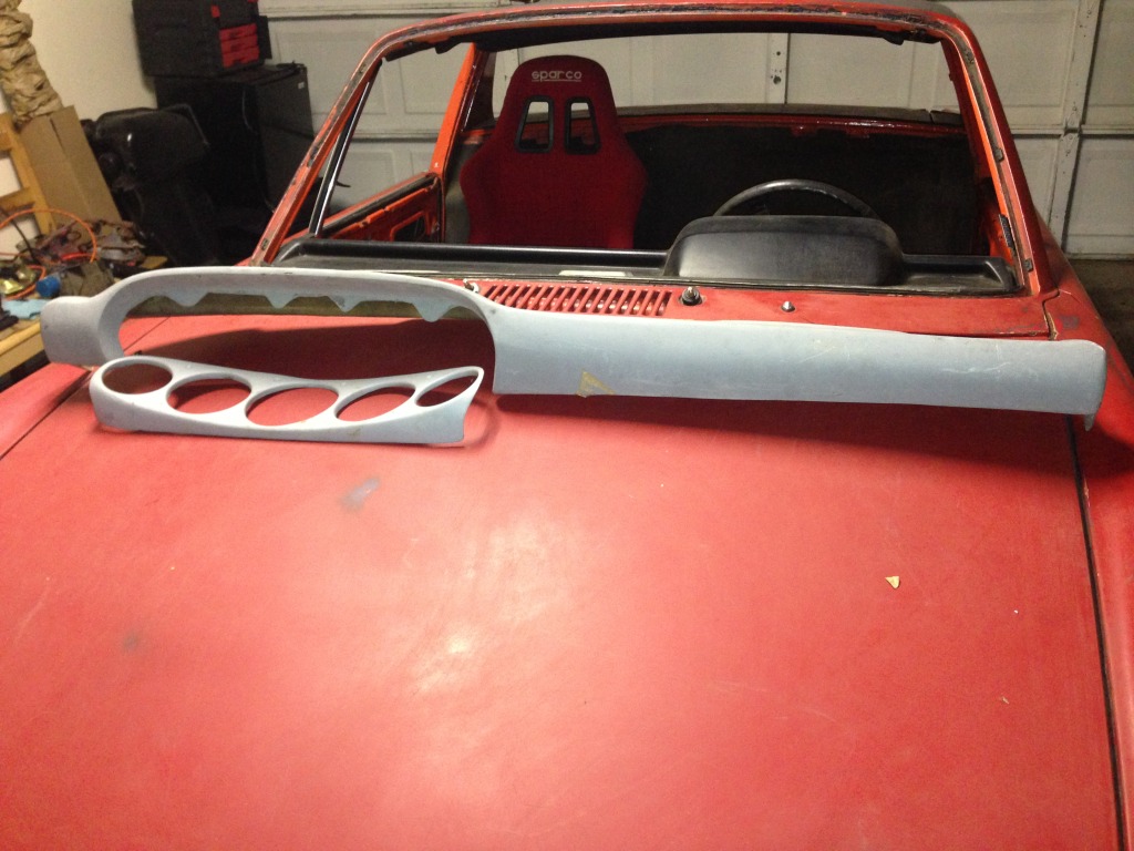

Havent updated in a few days...been sick (IMG:style_emoticons/default/headbang.gif) Also didnt get much of anything accomplished in the past few days, just a few small things here and there. One thing i did do today was finally unpack a box of goodies (that i actually got from danny hunter a few months ago.) I unpacked a FG rear 916 bumper and a FG 911 5 gauge pod dash. They are in pretty good condition and will only need minor amounts of repairs to make perfect. I held the bumper on to see if i could get a feel for the fit, it looks decent, but will need some fine tuning, as do all FG parts.
Question regarding the condition of my starter motor. Since the PO had that extra starter solenoid, it leads me to believe that either the whole unit is weak, or just the stock solenoid is week. Because even when trying to start the engine, with the extra one on there, it had a hard time turning it over, and went very slowly. Should i just replace the whole unit? new solenoid is about $60, rebuilt stock starter motor complete is about $110... I would like to take it apart first but i dont know what i would be looking for (IMG:style_emoticons/default/poke.gif)
Doug, thanks for looking and glad you have those kits, and in both sizes as well, I'll have to check what the pitch is. As far as getting the longest one they have, what about accounting for the fact that the hole is only partially threaded. The threads dont start until just under half way up..
Here are the pics of the new FG pieces.
