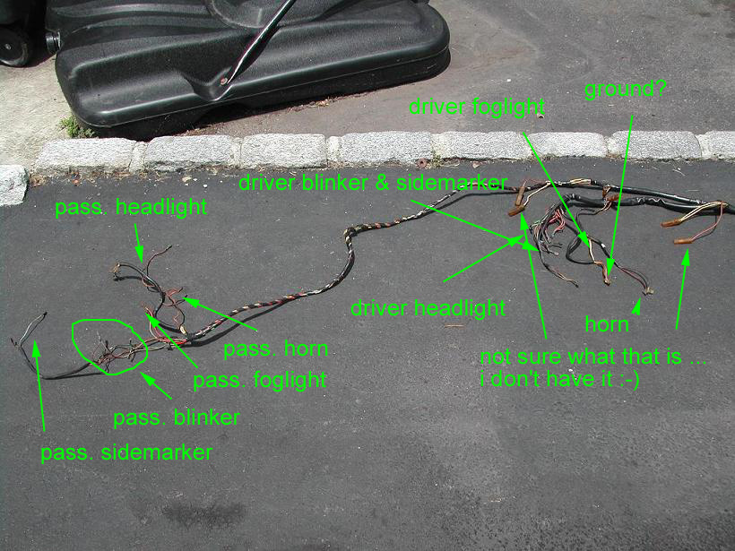

i need your help..i just got a wiring harness in the mail...and im trying to identify all the parts...i did a little..but i couldnt get far..im not very good at reading the wiring diagrams
so i took pictures of each part and im hoping you guys could possibly tell me where they go
i really appreciate all the help i can get

and the front ...

Dave_Darling   Step 1--buy yourself a Haynes manual and turn to t...   Jun 24 2004, 09:52 AM
SirAndy   yupp, will help. i need to go and get breakfast fi...   Jun 24 2004, 10:21 AM
SirAndy   ok, before i go into more detail, what year is you...   Jun 24 2004, 01:38 PM
SirAndy   rear first ... NOTE: where is says "fuel pump & o...   Jun 24 2004, 01:59 PM
SirAndy   fuel injection harness, others may chime in here, ...   Jun 24 2004, 02:06 PM
SirAndy   main section ...   Jun 24 2004, 02:16 PM
SirAndy   and the front ...   Jun 24 2004, 02:34 PM
Jeff Bowlsby   You are phenominal Andreas...   Jun 24 2004, 02:38 PM
SirAndy   a few tips about installation: the whole harness ...   Jun 24 2004, 02:41 PM

SirAndy   one more:   Jun 24 2004, 02:48 PM
Frank S   one more: I'm a bid confused, is the red l...   Sep 16 2016, 02:17 AM
SirAndy   I'm a bid confused, is the red line on the pic...   Sep 16 2016, 11:16 AM
Frank S   I'm a bid confused, is the red line on the pi...   Sep 17 2016, 03:33 AM
Daryl32   one more: Thank you Andy!!!!...   Feb 19 2020, 08:44 AM
SirAndy   Still not sure how to tie-up/mount the bundle of w...   Feb 19 2020, 11:38 AM
