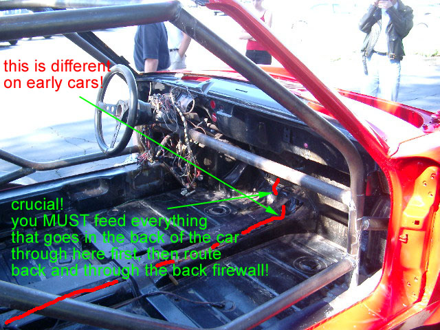

SirAndy   a few tips about installation: the whole harness ...   Jun 24 2004, 02:41 PM

Frank S   one more: I'm a bid confused, is the red l...   Sep 16 2016, 02:17 AM
SirAndy   I'm a bid confused, is the red line on the pic...   Sep 16 2016, 11:16 AM
Frank S   I'm a bid confused, is the red line on the pi...   Sep 17 2016, 03:33 AM

SirAndy   Still not sure how to tie-up/mount the bundle of w...   Feb 19 2020, 11:38 AM
