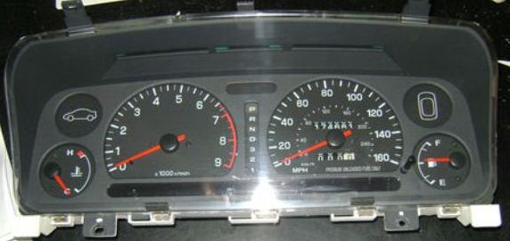

SVX's are all automatics...the cluster is a little large and squareish..
Here it is:
I don't mind the gauges themselves too much but no need for the other stuff and the PRND321. Maybe I could Frankenstein these into a new cluster...I thought about transplanting the guts into the VDO's but they don't line up at all...

strawman   ... been looking at stock Subie gauge clusters......   Jan 27 2013, 01:58 PM
904svo   [quote name='Chris H.' post='1810259' date='Jan 2...   Jan 27 2013, 04:33 PM
strawman   The trouble with using the Subaru Speedo is that i...   Jan 27 2013, 06:49 PM
76-914   Hey Chris, what's that cluster from the SVX lo...   Jan 27 2013, 12:11 PM
Chris H.   SVX's are all automatics...the cluster is a li...   Jan 27 2013, 12:43 PM
Chris H.   Thanks guys.... Geoff if I end up using the stock...   Jan 27 2013, 05:35 PM
DBCooper   There's an aftermarket VDO electrical speedome...   Jan 27 2013, 10:49 PM
Chris H.   Is it this one? Certainly a good option. Fit...   Jan 28 2013, 08:00 AM
DBCooper   Yup, that's it. Found a photo: http://www.91...   Jan 28 2013, 09:13 AM
904svo   It's answer like these that take the scare out...   Jan 28 2013, 11:07 AM
