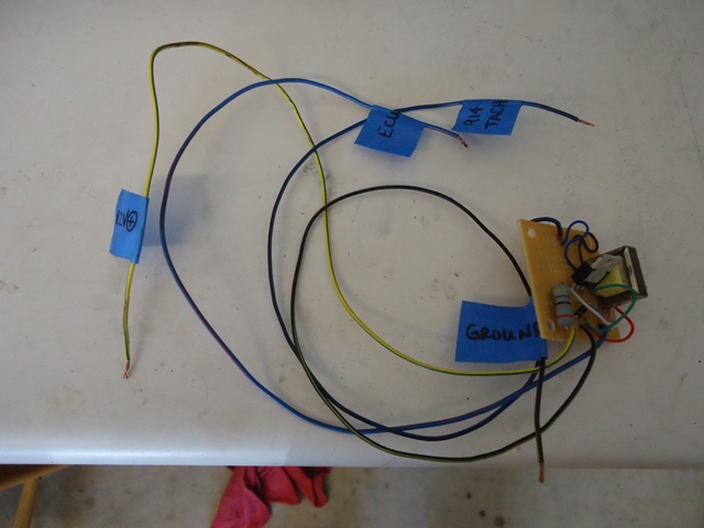

Hey carrying over my hijack of strawman's thread (sorry man) ... been looking at stock Subie gauge clusters... does anyone know if the tach needs calibration like a 914's? How about compatibility?
The reason I ask is that the bone yards and e-bay show compatibility with either 4 cylinder or 6 cylinder cars. Example:
Legacy Cluster
Note how it says either 2.5L or 3.0L...Could be a mistake...
my ideal setup would be something like this:
2004 WRX
Or this:
05 STI
Just not sure if it would be possible without more $$$$ than the Speedhut setup.
Any insight would be appreciated.

QUOTE(Chris H. @ Jan 27 2013, 09:06 AM) *
IMHO, the easiest solution is to match the cluster's native number of cylinders with the sixer in your car. But I'm sure there's a way to use resistors, amps or clamps (or some other techie solution!) in-line between the ECU and Suby cluster if you choose to go with a WRX cluster. All of the Legacy gauges I looked at were too wide for my liking, but if you're gonna hack up the 914 dash anyway (like I did!), I guess it really doesn't matter.
904svo (Larry) is an electrical whiz and REALLY helped me build a converter to use the 914 tach. (IMG:style_emoticons/default/beerchug.gif) I've still got the converter (see below) and could pass-it-forward if you can use it, though you'd need to convert it to work with the six-cylinder signal. PM me if you're interested (and be sure to thank Larry!).
You'd still be challenged with the speedo, since the Suby uses a VSS signal versus the cable-driven 914 speedo. I looked at using a VSS-based 911 speedo, but my cheap-ass couldn't stomach paying ~$100 for a questionable used one and prolly need to send it in for a $350 rebuild... most of the cheap ones are 85mph, too. (IMG:style_emoticons/default/barf.gif)
Keep up the great work!

QUOTE(strawman @ Jan 27 2013, 11:58 AM) *
Geoff
That tach adapter will drive a 911 tach off a 6 cylinder engine also.
The trouble with using the Subaru Speedo is that it will only read the correct speed if you use the same tire size as the Subaru, also there is no way to fix it as it control by the speedo chip in the gauge panel.
