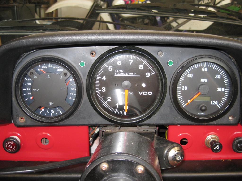

Yup, that's it. Found a photo:
(IMG:http://www.914world.com/bbs2/uploads_offsite/i379.photobucket.com-2618-1359386016.1.jpg)
Fully programmable so you can change tire height and correct the speedo. The tach is also VDO, with a programmable shift light (that LED just above the VDO logo). The shift light looks small but it's pretty bright, without looking like a drag racer. And it goes up to 9K, appropriate for a Subaru engine that spins higher than a T4. It was about $100 from e-bay new in the box. The fonts and style are the same so it leaves the dash looking "in the style of" the original, but with modern instruments. The tach and speedo needles have absolutely no bounce, are perfectly steady. They work well and are simple to install. Important to note that I use an aftermarket EMS, so no need to retain any Subaru compatibility for ECU function.
They're great, the only real problem is lighting at night, they're all a little different. I still haven't changed the bulbs in all so they match. That photo makes the needle colors look different, which is odd, but in real life I can't tell the difference.

strawman   ... been looking at stock Subie gauge clusters......   Jan 27 2013, 01:58 PM
904svo   [quote name='Chris H.' post='1810259' date='Jan 2...   Jan 27 2013, 04:33 PM
strawman   The trouble with using the Subaru Speedo is that i...   Jan 27 2013, 06:49 PM
76-914   Hey Chris, what's that cluster from the SVX lo...   Jan 27 2013, 12:11 PM
Chris H.   SVX's are all automatics...the cluster is a li...   Jan 27 2013, 12:43 PM
Chris H.   Thanks guys.... Geoff if I end up using the stock...   Jan 27 2013, 05:35 PM
DBCooper   There's an aftermarket VDO electrical speedome...   Jan 27 2013, 10:49 PM
Chris H.   Is it this one? Certainly a good option. Fit...   Jan 28 2013, 08:00 AM
DBCooper   Yup, that's it. Found a photo: http://www.91...   Jan 28 2013, 09:13 AM
904svo   It's answer like these that take the scare out...   Jan 28 2013, 11:07 AM
