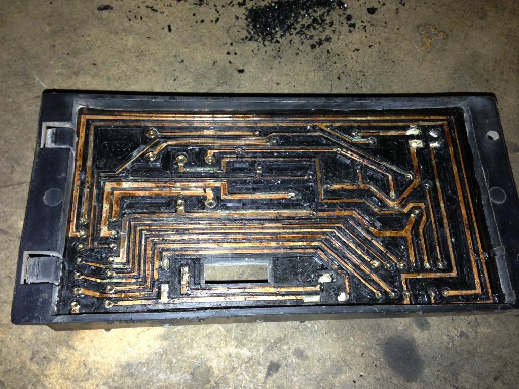

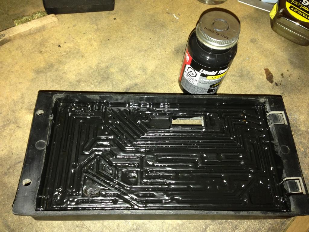

First thing i did was take off all the old cracking and crumbly insulation material on the backside of the relay board. Once it was all off i checked continuity of all the wires, all were good! Then i applied two coats of new liquid electrical tape, i hope it holds up well, i may add another coat just to make sure. (IMG:http://www.914world.com/bbs2/uploads_offsite/i1293.photobucket.com-14538-1359573620.1.jpg) (IMG:http://www.914world.com/bbs2/uploads_offsite/i1293.photobucket.com-14538-1359573620.2.jpg) After that i took the heads off the engine to inspect the piston tops, cylinders and valves. Bent two push rod tubes in the process, there goes $20. The inside of the cylinders look really good, can still see the honing lines. The piston tops look ok, no dings or anything like that, but they are SOOO dirty, so much carbon build up. And same with the heads, the valves are just covered in carbon. I know why this engine didnt want to start easily, the engine was running extremely rich and probably wasnt tuned correctly. I need everyones opinion, I would like to save and reuse them, so how and with what can i clean the heads and piston tops. I would like to not remove the cylinders because i couldnt source rings on either pelican or AA, and would need a ring compressor. so whats your take.... (IMG:style_emoticons/default/popcorn[1].gif) (IMG:http://www.914world.com/bbs2/uploads_offsite/i1293.photobucket.com-14538-1359573620.3.jpg) (IMG:http://www.914world.com/bbs2/uploads_offsite/i1293.photobucket.com-14538-1359573620.4.jpg) (IMG:http://www.914world.com/bbs2/uploads_offsite/i1293.photobucket.com-14538-1359573621.5.jpg) (IMG:http://www.914world.com/bbs2/uploads_offsite/i1293.photobucket.com-14538-1359573621.6.jpg) Thanks |

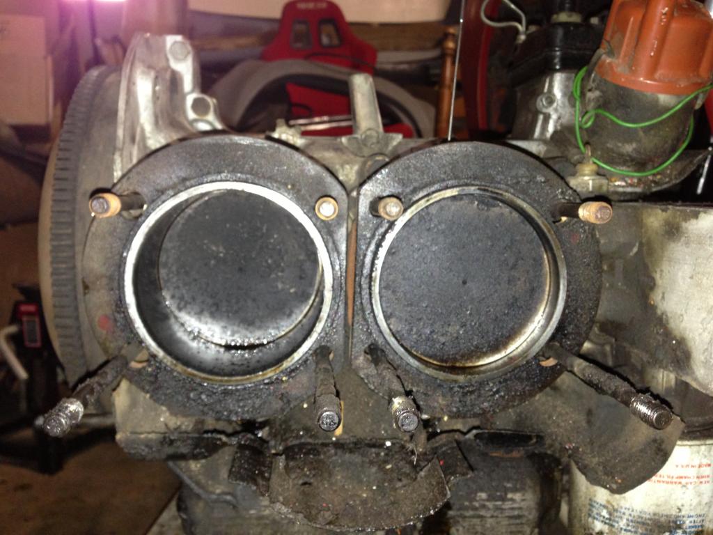

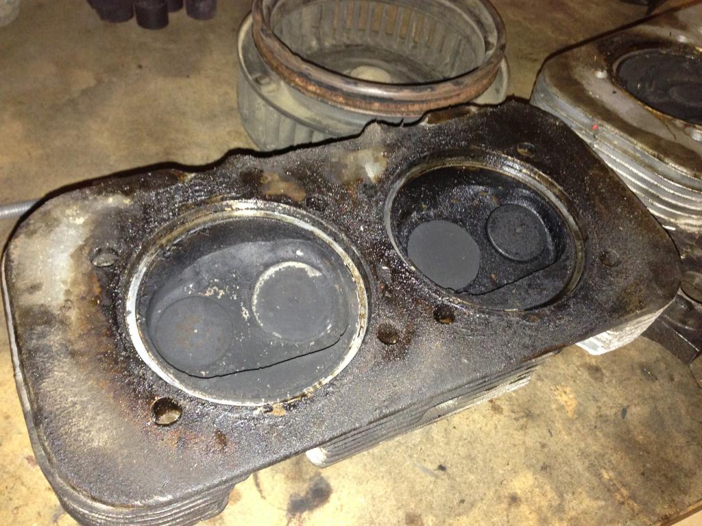

Millerwelds Anyone have any ideas about the odd dulling of one... Jan 22 2013, 09:04 AM
dfelz
It is from the spring that holds the lifters in ... Jan 22 2013, 09:44 AM

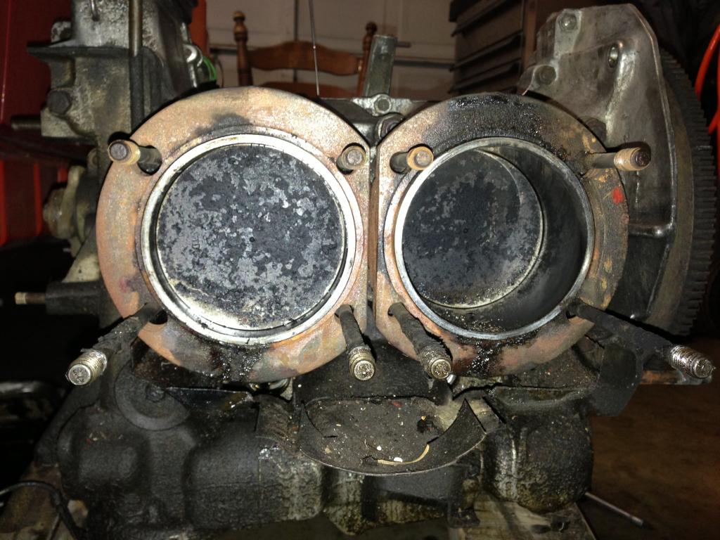

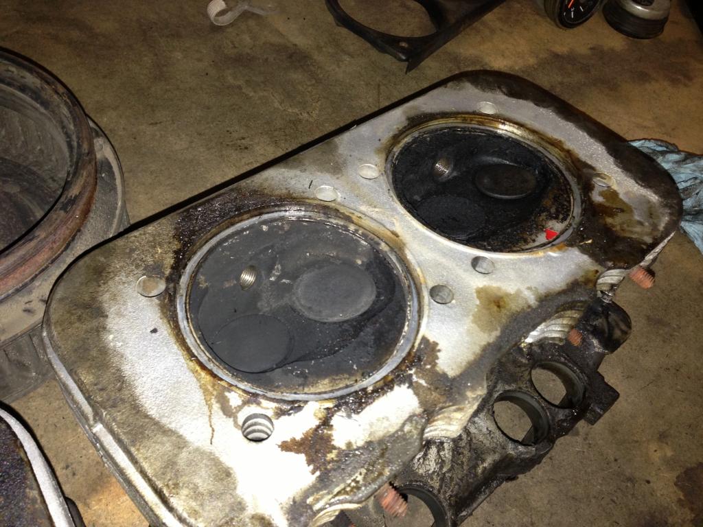

dfelz Havent updated in a few days...been sick :headban... Jan 26 2013, 11:34 PM
Kirmizi Before spending money on a new starter and/or sole... Jan 27 2013, 10:40 AM
dfelz
Before spending money on a new starter and/or sol... Jan 27 2013, 06:47 PM
injunmort the heads, i would take to local machine shop and ... Jan 30 2013, 02:46 PM
'73-914kid That thing was running RICH to get that much carb... Jan 30 2013, 03:44 PM
euro911 Dave, I have a shitload of freshly plated push rod... Jan 30 2013, 04:04 PM
dfelz I will have to look into purchasing an AFR! wh... Jan 30 2013, 04:47 PM
euro911 I will have to look into purchasing an AFR! wh... Jan 31 2013, 01:55 AM
dfelz
[quote name='dfelz' post='1812207' date='Jan 30 2... Jan 31 2013, 11:10 AM
euro911 Will you be at the dawn patrol run this Saturday? ... Jan 31 2013, 04:44 PM
dfelz
[quote name='dfelz' post='1812592' date='Jan 31 2... Jan 31 2013, 04:55 PM
Kirmizi 96mm means you've got a "big bore" k... Jan 30 2013, 06:04 PM
mrbubblehead hey david, if you wanna buy the soda your welcome ... Jan 30 2013, 07:16 PM
dfelz
hey david, if you wanna buy the soda your welcome... Jan 31 2013, 05:06 PM
'73-914kid Care to share those mods? I'm getting ready to... Jan 31 2013, 12:55 AM
Dasnowman I know it looks like it's running rich but on ... Jan 31 2013, 02:12 AM
dfelz
I know it looks like it's running rich but on... Jan 31 2013, 11:43 AM
'73-914kid Call AA performance. Theres a good chance your big... Jan 31 2013, 04:54 PM
euro911 Soda (baking powder) won't hurt the internals,... Jan 31 2013, 05:27 PM
