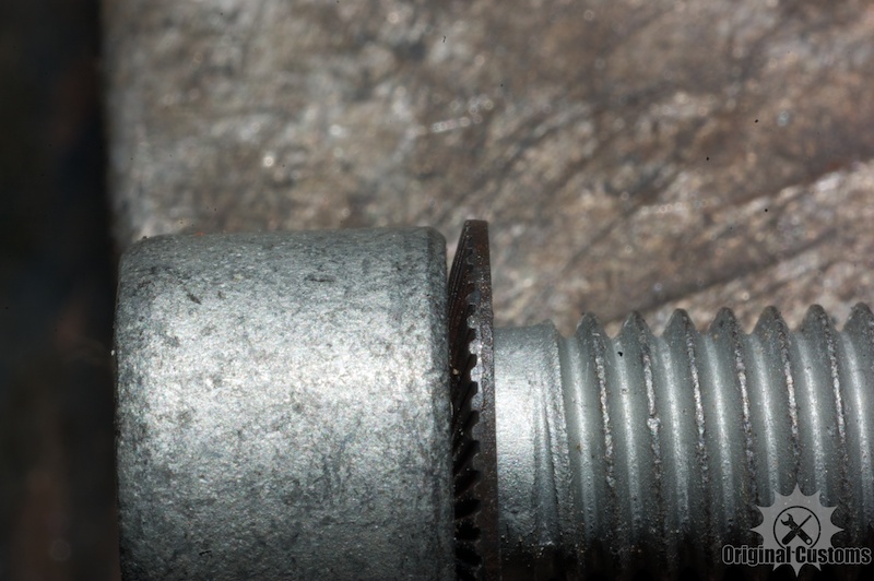

Since we are talking about these little washers. Is there a correct way they should face or it doesn't matter. Know what I mean ?? :-)

QUOTE(porsche913b_sp @ Jan 30 2013, 03:38 PM) *
Absolutely! (IMG:style_emoticons/default/biggrin.gif) The ID should be towards the bolt head. I guess a picture is better...

McMark   The washers are serrated on both sides. It just d...   Jan 31 2013, 10:14 AM
