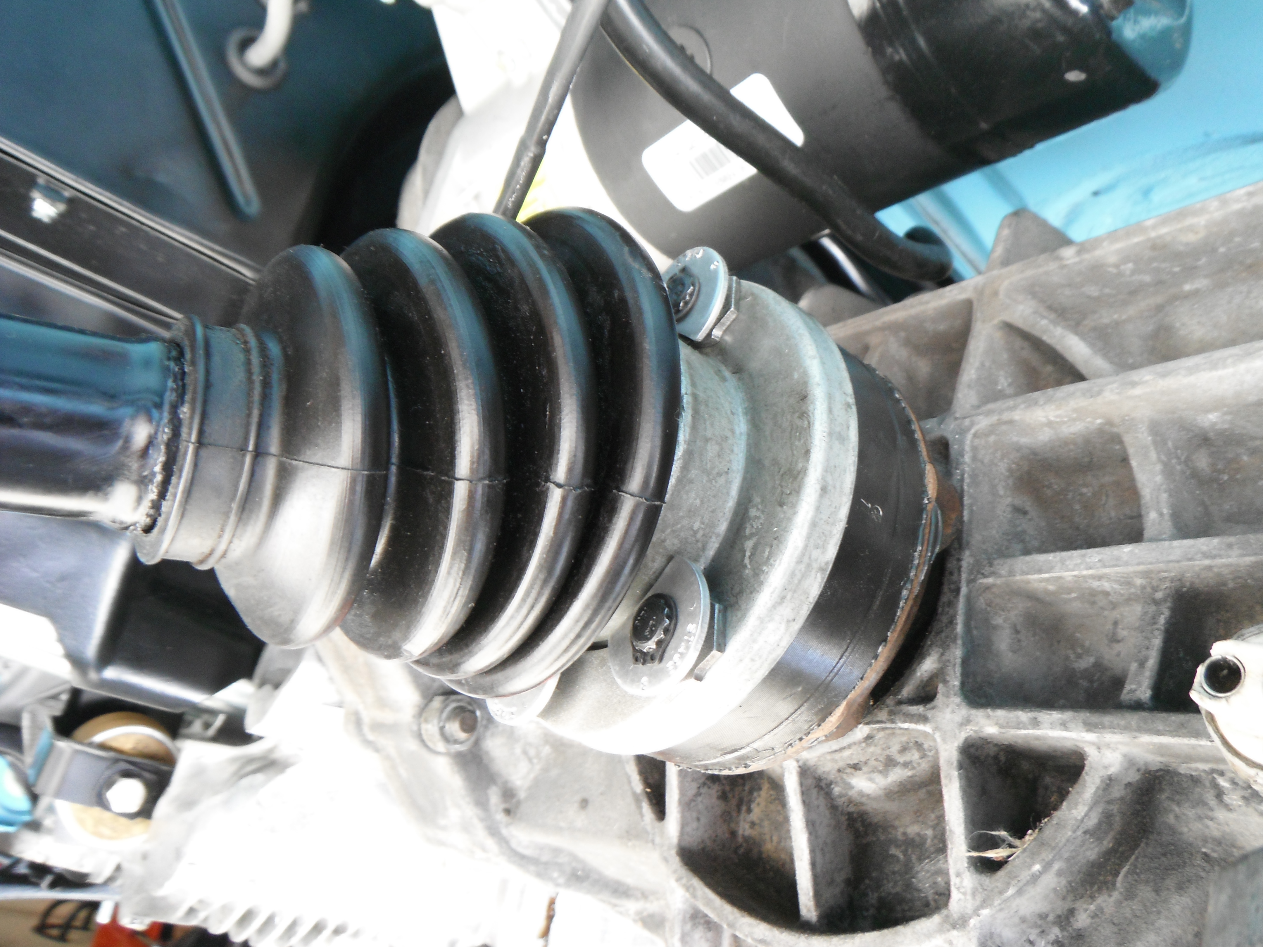

I sent to Pellican for CV bolt lock washers. I think I could have found these at the local hardware store. Are the others not available anymore. Should I trust these?

how about these

rick 918-S   Actually, I found schnorr washers at my local Ace ...   Jan 28 2013, 08:13 PM
Elliot Cannon   There is an Ace hardware in town. I'll check ...   Jan 28 2013, 08:15 PM
Racer Chris   Bad on Pelican. I buy Schnorr washers a hundred at...   Jan 28 2013, 08:21 PM

dlestep   serrated, black oxide spring washer (Schnorr)   Jan 28 2013, 08:30 PM

A&PGirl   Belleville and Schnorr are actually (2) different ...   Jan 30 2013, 10:14 AM
rhodyguy   whats the dif between the belleville and the schno...   Jan 30 2013, 10:18 AM
Phoenix-MN   From the Schnorr handbook The benefi ts of SCHNOR...   Jan 30 2013, 10:28 AM

rhodyguy   so...pelican lists them as superseded to 999 523 1...   Jan 30 2013, 11:08 AM
McMark   McMaster washers come in a bag labelled SCHNORR in...   Jan 30 2013, 05:21 PM

McMark   The washers are serrated on both sides. It just d...   Jan 31 2013, 10:14 AM

montoya 73 2.0   Schnorr washers are stock and good enough, Safety ...   Jan 31 2013, 08:14 PM
Elliot Cannon   Might be a good thing on a race car. Looks like a...   Jan 31 2013, 08:17 PM
montoya 73 2.0   Ah, good idea for quick release on the triple squa...   Jan 31 2013, 08:21 PM
