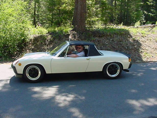

I picked up a set of 951 Fuchs today, 7&8 x 16. They are ugly, which is fine by me as I would like to have them blasted and do an RSR finish.
Search tells me that they have been fit to narrow body cars, but I would like to know what must be done in the rear to make them fit. I would also appreciated pictures and get some insight on tire sizing as well as ideas for spacers for the front.
Thanks,
Ken
sixnotfour
post Feb 3 2013, 01:58 AM
Posts: 11,414
Joined: 12-September 04
Member No.: 2,744
Harold's 914-6 is awesome, but if lowered he would be rubbing, I had them on a 914 that was low , I started with 7's a bit of fender rolling with a 1x2 wood board, A while later switch to the 16x8 951's and had to go a bit more same method. I don't know if the roller would work as the rear fender is not a true radius.

kg6dxn   You just need to roll the fenders. Esatwood makes ...   Feb 3 2013, 12:49 AM

HaraldD   Hi, here are 2 Fotos of my car. It is maybe 1 inc...   Feb 3 2013, 06:49 AM
bigkensteele   Hi, here are 2 Fotos of my car. It is maybe 1 in...   Feb 4 2013, 12:28 AM

HaraldD   Hi Ken, thank you very much! Yeah - these are...   Feb 4 2013, 01:47 PM
