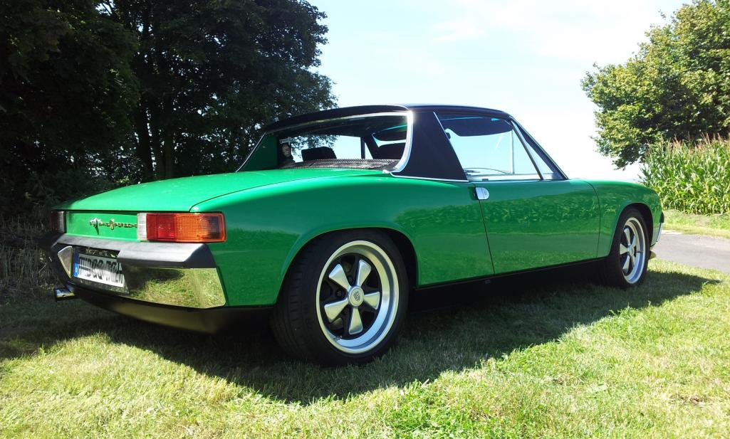

Hi Ken,
thank you very much!
Yeah - these are 951 rims in 7x16 ET 23,3 and 8x16 ET 23,3 in the back. Tire sizes are 195/50/16 and 205/55/16. I get the wheels anodized like the originals (15") - it looks real good.. (IMG:style_emoticons/default/shades.gif)
